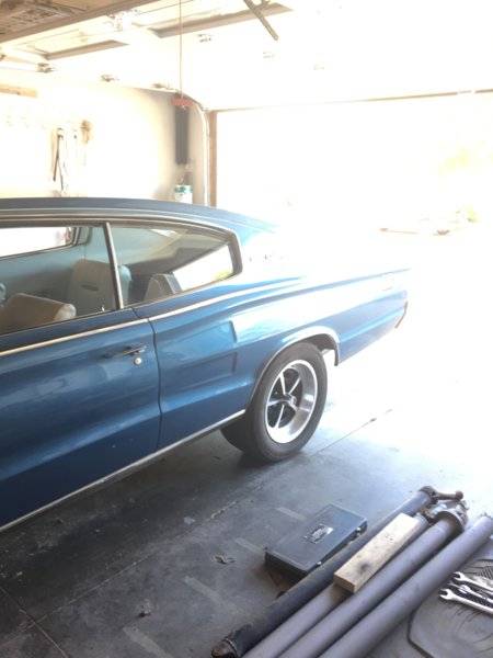

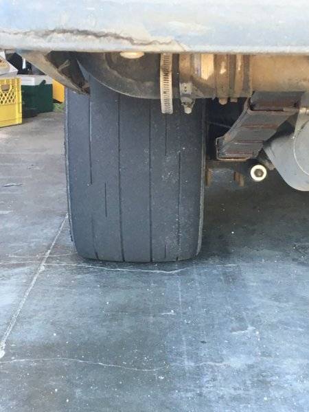

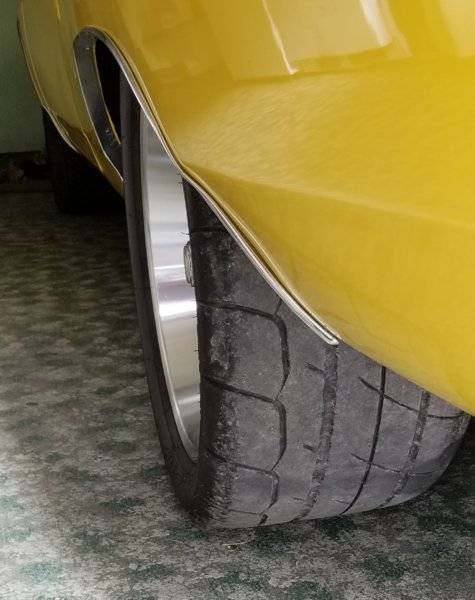

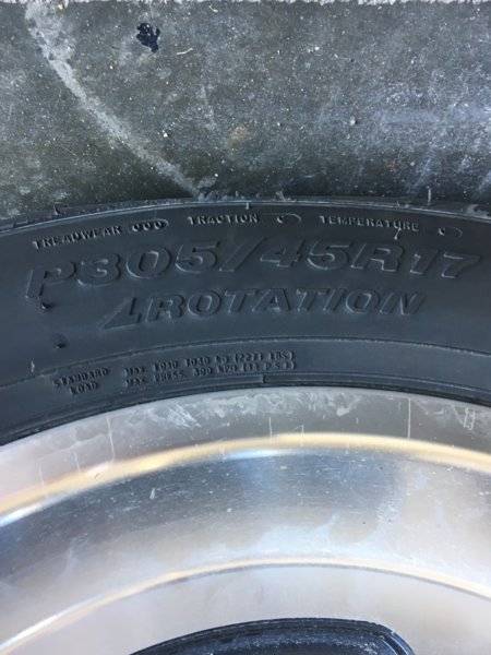

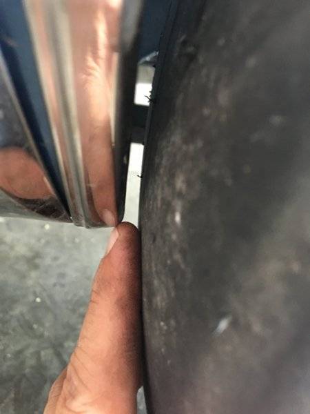

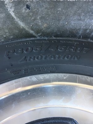

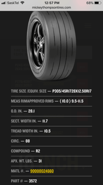

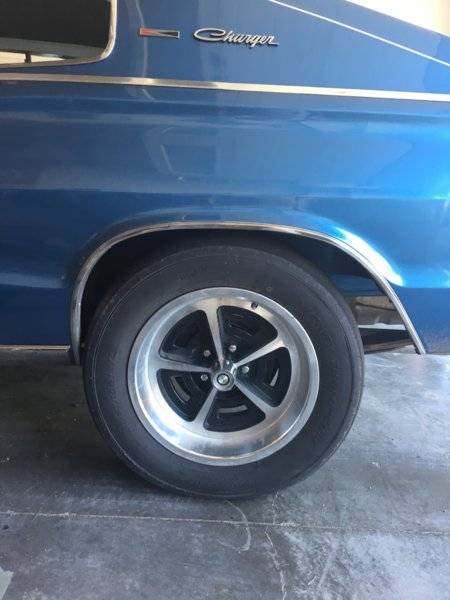

17” cast aluminum magnum 500s, 8” on front, 9” on rear and 5 1/8” back space. 305/45r17 Mickey Thompson et street 28.1” tall on rear. I have a 67 Charger, not cut or mini-tubbed. Stock location for now but likely to change- I have 1/4”-3/16” clearance (I avoid mud racing!)
These fit, but just barely. The height issue is the main problem with 66/67 chargers. I wanted a tall tire but the front wheel well is tight. Dana 60 going in soon and will be pushed back.
For 17” rims it’s really hard to find any tire that tall of any manufacturer.

That rear needs to come back at least 1 inch! I foresee tire and or quarter panel damage in your future.

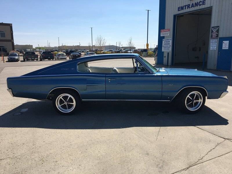

Sorry for the the long delay, haven’t been on for a while. The d60 caused problems, different length drive shaft and bangs the stock gas tank. My car is basically stock, so I put the 8 3/4 back in and removed the 1/4” alum shims at the front shackles so it’s stock again.

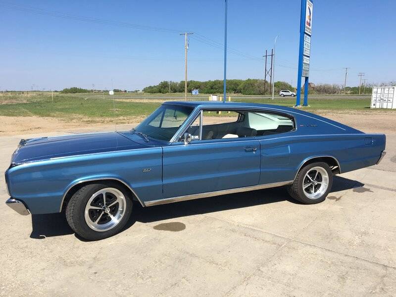

Big issue with Gen 1 chargers is the front spacing of the rear tire. A wide tire, 295, is doable but there is precious little room, 28” tall is basically the max without doing something. 1/8” clearance the front, 3-4” behind the wheel. So for drag cars it’s pretty normal to radiance the wheel well, or mini-tub and tuck the tires in, or push the axle back, or some combo. I generally skew stock too, except for racing and I had put this car down the track one season. But it’s nearly 4000lbs, a stick, and a driver, so it’s not great on the track (FUN! But not great for it).
Pics are stock location, but the tires are 25.5” tall on the rear and reasonably wide at 285. More options on 15” rims, these are 17”.
