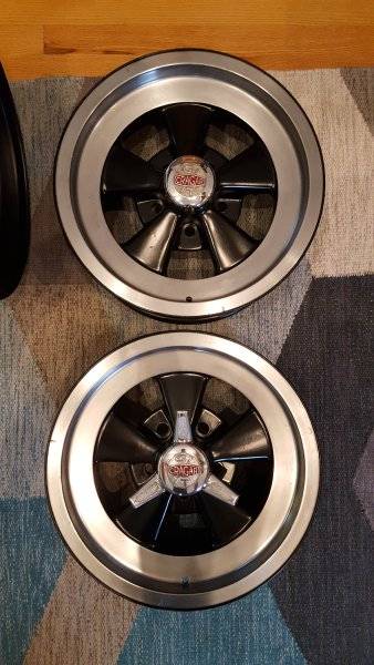

And either my crappy Cragar GTs, or my shiny ones pictured below, possibly with spinners.
What say you?
