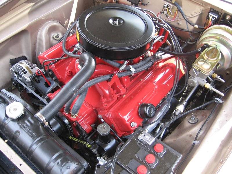

This is a 390 Stroker using Toth parts. The thing is in a 64 Dodge wagon.
It's a runner.
The intake is a Chrysler Power Dual Plane Wind Tunnel.
Try POLYSUPERPAC.COM out of Texas. It's been awhile I hope they are still around.
OR Toth Performance 724-290-2497 out of Pennsylvania.
The car isn't mine but I assure you it has a Edelbrock. Maybe a AVS2 650.
My buddy won't use anything but the Carter style AFB AVS on anything he drives.
He also owned a big body shop so I'm sure they mixed up as close to the factory red of 1964.
This is the car. I drove it. I will hold it's own against any Big Block.
