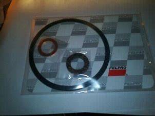

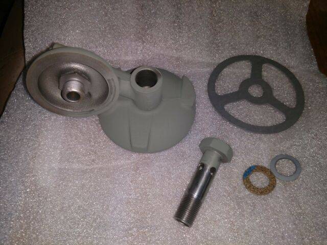

Just to reiterate what we have all told you, if your gasket looks like the one in the pic on the right or contains the two small ones, don't use them, only the single outer large ring shown in the pic on the left.

Just a follow up…70522 gasket worked great. Torqued to 50 ft lbs. no leaks…Engine is tight now except for very minor seepage from valve covers. Thank you to all who posted and helped me. I really appreciate it. So nice to look under car now and NOT see several puddles of oil.
