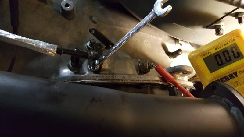

This is easy to check first...
Hook up an ohms meter to the switch on the transmission. One lead on the terminal and the other to a good place on the trans. You can sit in the car and have your meter on the floor where you can watch it. (This doesn't require the key to be on.) Now place the shifter in reverse and your meter reading should be "0" or an open circuit. Then place your shifter in neutral. This should show a reading or a closed circuit. Then place it in drive and the meter should show a open circuit again.
You will get a sence as right where the switch is being activated. If it favors one position more than the other, like when coming out of the drive position it takes longer to get your reading and coming out of reverse you get a quicker reading, then a small adjustment is needed. That's what I'm thinking your problem is.
The adjustment is made with the wheel on the end of the cable that's bolted to the trans. (Refer to the article in the second link) Remove the small bolt and turn the wheel to the next hole. (Turning the wheel clockwise lenthens the cable) It doesn't take much. Two holes could be too much in some cases. This procedure is good for checking if you have a faulty switch also. That would be the next step if adjusting the cable isn't having any results.

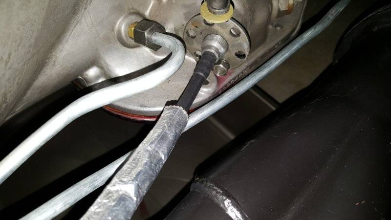

Heres some pics...
Any questions just hit us up. Update with your results.
