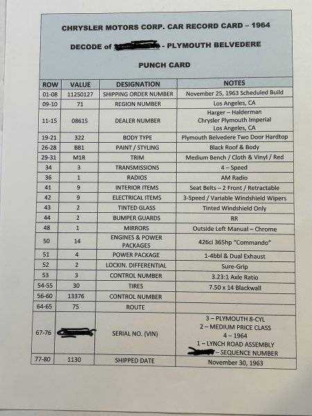

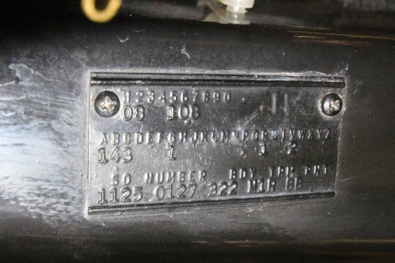

Here’s a picture of the fender tag for my 426 Street Wedge car that was built at Lynch Road. What’s odd about it is that it was sold in L.A. I thought that they were building B-body cars at the L.A plant at that time.

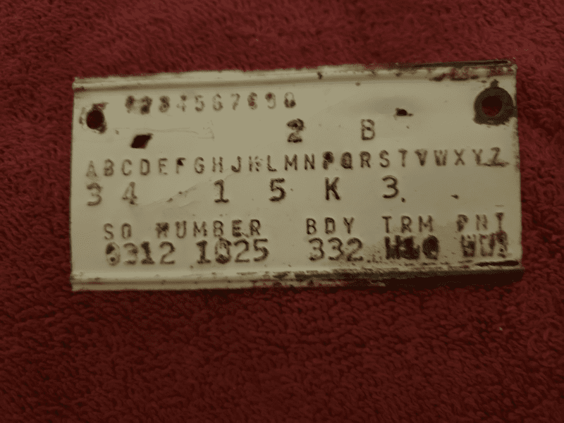

Interesting discussion.....Here's my 64 Fury tag that I decoded 25+ years ago. I don't recall when, where or who I received the info from but I was told that it was a 361 4spd and a radio plus a few other codes. Of course this was back when all the synapses were firing & I figured that they always would.....now, not so much.
