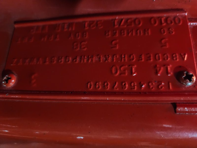

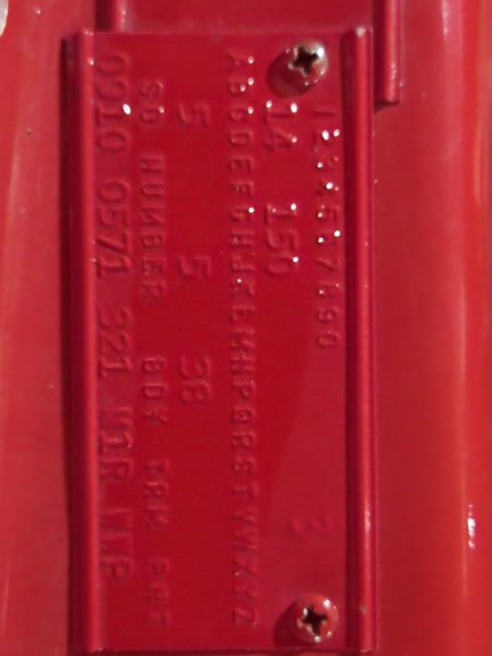

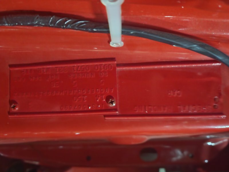

Is your car a Canadian car? Fender tag? The 64 Canadian polaras used the convertible trunk pan, which put the spare tire bracket in the right rear corner of the trunk, unlike the American ones in the front center of the pan
The car is a USA car so it will be in front of pan I guess I waiting for the bracket to come in I will try post fender tag thanks

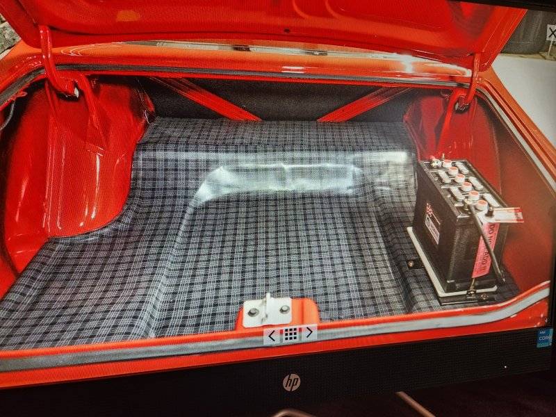

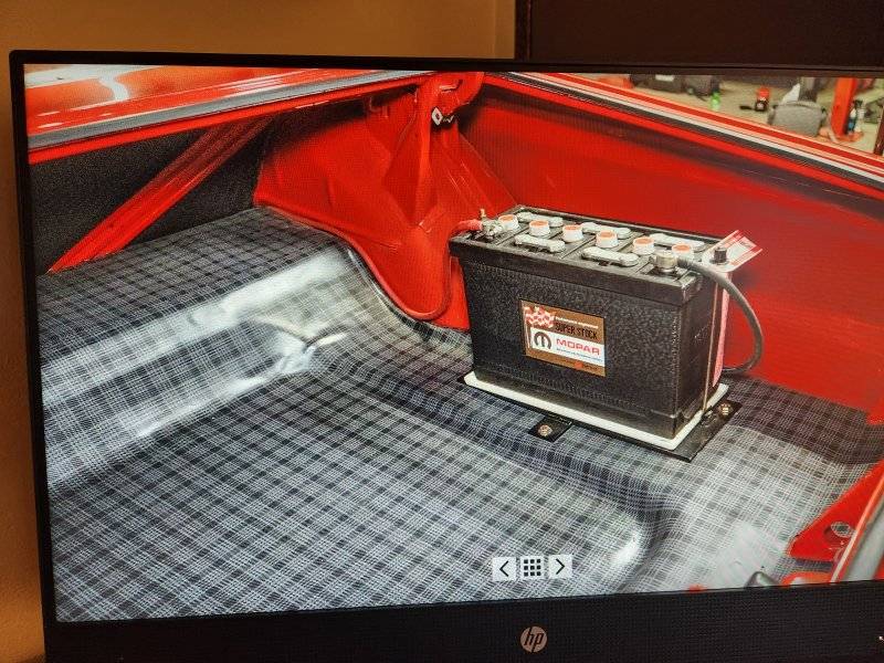

FWIW my original 63 SF vert has the spare mount on the right side, where your battery is!

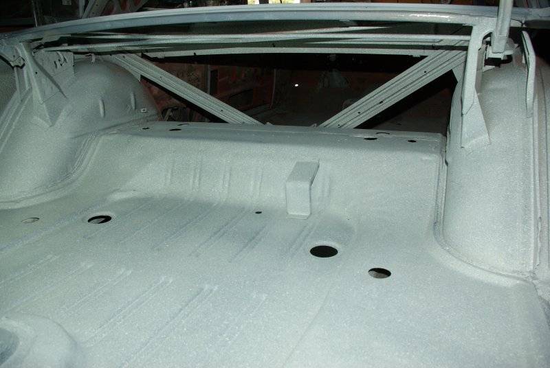

I was to believe that all early B body had the Ziliatone gray paint treatment in the trunk? Was I wrong?

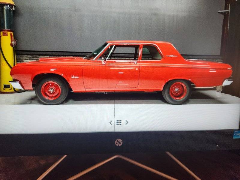

Nice looking car.
