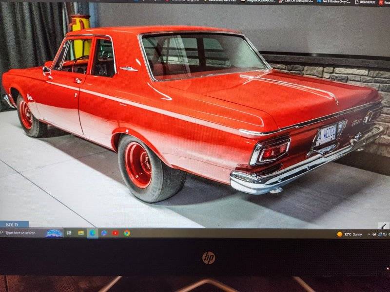

hi i just went out and bought some 15x 10 pie crust tires for my 1964 belvedere was wondering on what you guys thoughts if i should buy 15x8 or 15x 10 steel wheels to mount them and i have seen some rear r]steel rims on max wedge cars painted 2 different colours was this a factory thing i might consider doing that my car is red so what would be the other colour on the rim be thanks

Great thanks I have 11.5 hooser on 10 inch now that fit but I figure with smaller tire would go with a smaller rim thanks maybe I will paint the rim thanks
