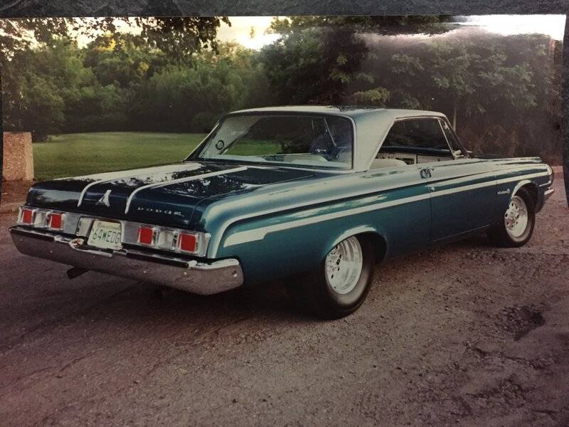

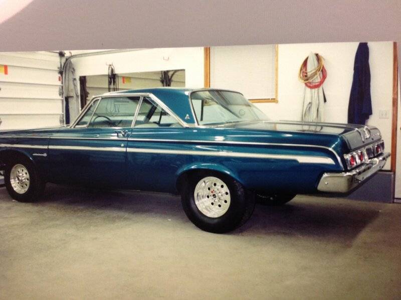

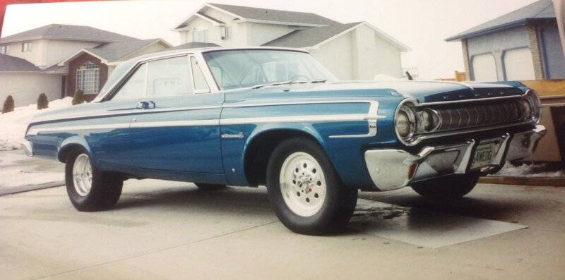

Standard Polara trim package.... NOT a 500. The Red fill on the side trim is my custom touch. Was originally just chrome. Raised "Polara" on the hokey stick is stock and was a cream color from the factory. Also... center backup lights have been deleted and converted to third tail lights because sequential turn signals were added.
Cool I want to o that to mine also, can you give us the run down on how to do the conversion? did you use LED's?

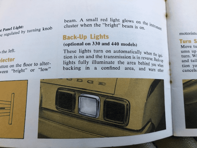

This tail light set-up with 3 lights on a small backing plate was used exclusively on Canadian Dodge 440 series. However, I have a fall 1963 magazine article announcing the new 1964 cars. I imagine some of he cars were pre-production, because one picture shows a Polara sedan with this style tail light setup. Chrysler must have at least thought about it. Another idea that did not make it to production was 3 red tail lights per side for Polara 500. If you look at the body wiring diagram in '64 shop manual, it shows this for Polara 500 and the production red, white, red for Polara.

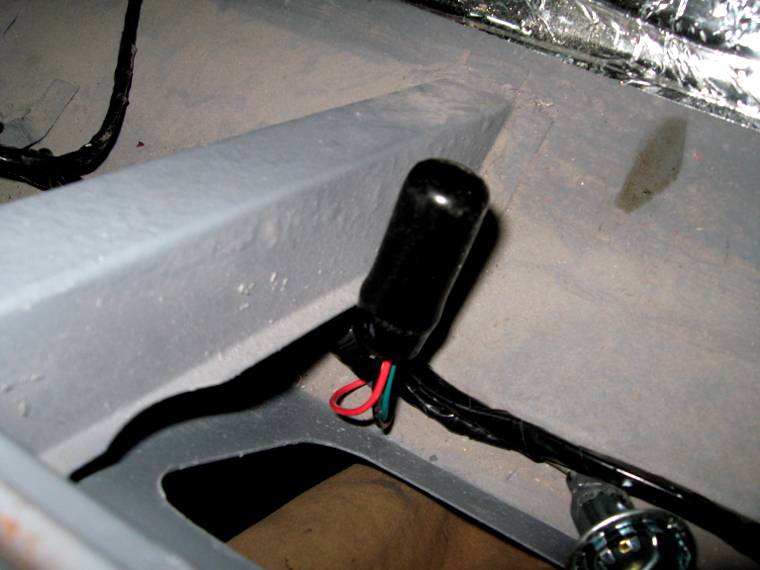

I used a kit from WebElectric. Here's a link.. https://zips.com/parts-detail/seque...K5x0w-4_pZ070ifINxdUmxt5bYDuVhBBoCiEoQAvD_BwE
Works with both LED and regular bulbs and they have kits for 2 or 3 tail light systems. Here's what the modules look like. One on each side. They also sequence the brake lights from inside to outside when the brakes are depressed. Works as an attention getter when you hit the brakes.
