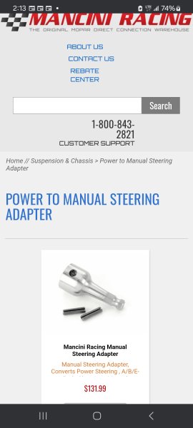

I used an adapter in my 64 to put a manual box in a p/s car.

The part I showed there makes a complete original power steering column mate to a manual box. The ends are for the different splines

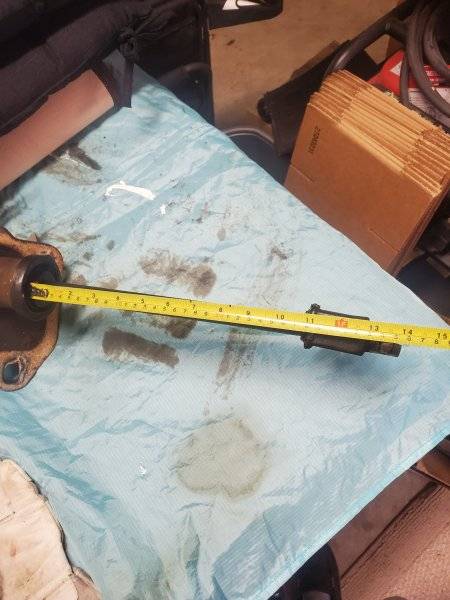

14" from the bottom of the seal to the end of the 3" coupler.

Just had a guy in Spokane (I have his power window switches to rebuild) measure one of his manual steering shafts / coupler. The shaft sounds about the same as mine (11" from the column lower seal to the top of the coupler)
