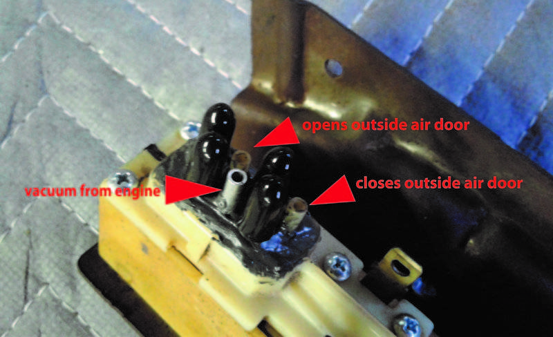

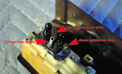

I definitely wanted to delete the heater...clean up the engine compartment, lose weight, not really needed, but I do live in Wisconsin and late-summer/early-fall cruising = fogging windshield. I did not want to use the factory heater delete cone because that does not direct air at the windshield. With only 2 buttons to control the HVAC I had an issue...and one of them is OFF ! So, my plan was to use the "COOL" button to control incoming outside air. I'm hoping that if I'm able to blow outside air at the windshield, it will keep it from fogging up. I will be retaining the blower motor.

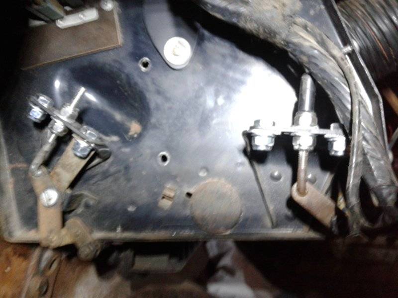

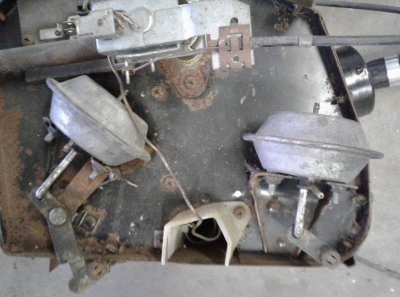

I disassembled the heater box and removed the heater core. All of the holes for heater hoses were plugged. I cut the rods coming off both dashpots and threaded them (12x24 NC thread) in order to lock them in place - both defrost and floor vent. I made a couple plates to replace the dashpots. The newly threaded rods hold the doors in the open position. I left rods long in case it doesn't work the way I planned, but it should work.
Stock dashpot arrangement
Modified/deleted dashpot rods holding both "defrost" and "floor air" doors in the open position.
