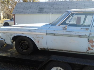

Well it’s here, car runs amazing. Starts up as soon as you bump the key all the electronics on the car work great...here’s the but.

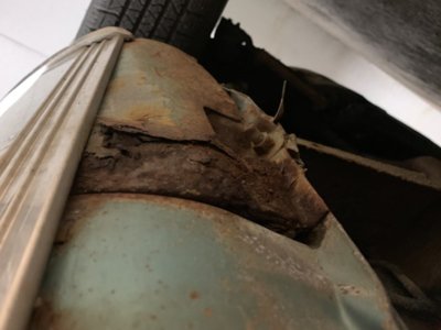

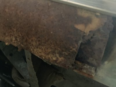

The bottoms of both fenders is bad, the drivers is completely shot, to the point that it doesn’t even attach to the body. The pass isn’t as bad. There are three holes in one spot of the rocker, and one small spot of rust about the size of a dime in the firewall by the ballast. Still great for an early B Body that I only have 6200.00 into after shipping and title work. But I’m disappointed the seller hid these small issues.

You'll be ok. Rockers will patch up fine and once the front fender is off if it's just the lower portion that's bad you can rebuild them. They do sell a lower patch panel for those, although they require some work to get them to fit right. If the fender turns out to be shot, replacements are a bit tough to find but can still be bought.
