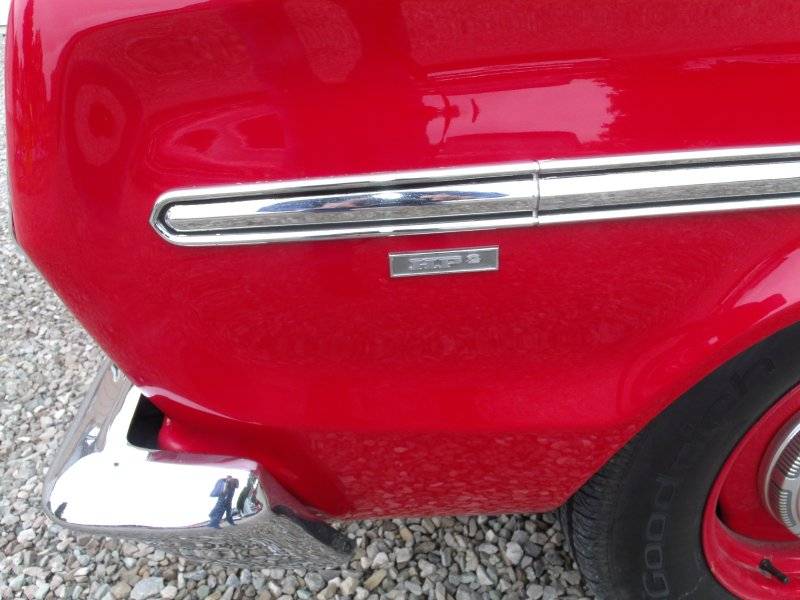

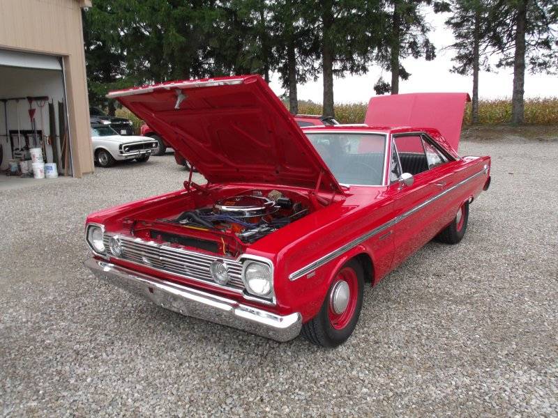

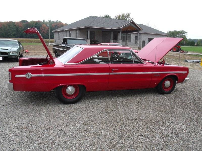

The reason I asked, was that I was asked to authenticate a 1966 Belvedere II 2-door hardtop, equipped with a Hemi, 4-speed, up here in Ontario, a few years ago. The car was an early build HP2, that had originally been painted Mauve Metallic. The car was now sporting a "Resale Red" paint job, and had some other non-original modifications that were easily reversible. The strangest thing, was that the bright side trim on this car was all chromed die cast pieces, where I was expecting aluminium or stainless! The patina of these pieces matched that of the HP2 signs, so I believe they were original to the car. I only authenticated that the car was actually a real Hemi car, but did not appraise it for value, as that is not my expertise.

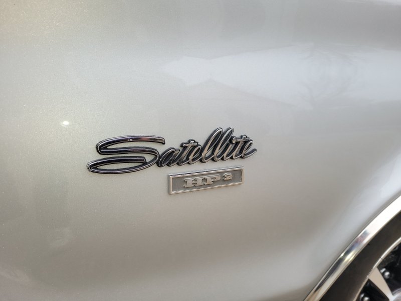

I talked with a Gent (4 hours on phone) who worked on the assembly line (trim) when the Hemi cars were made, he claimed they were not started till late Oct-Nov because of assembly problems that had to be fixed first. HP2 emblems we’re first then after Jan the Hemi emblem was on front fender, like my Jan 21st build date (I have a B II)

You sure that was chromed solid die cast “pot metal”?
I’ve seen many people chrome stamped aluminum trim. Especially years back it was easier to find a place to chrome the trim than have it buffed and correctly brite-dip anodized. Also, just the lack of knowledge by restorers.

I found my notes on this car. Build date was C14 = December 14, 1965. Engine block casting date was August 16, 1965. Paint was 661. VIN started RH23H61. Father/son team bought it to flip. Father would have liked to keep it, but son wanted $$$ out of it. Odometer only showed 11,000 miles. They said it had been raced in NY state; still had headers on it. I know it got sold, but do not know where it went.

Absolutely! It was getting that light speckling/pitting that only die cast gets, just like the HP2 signs on the car. The ends of the pieces at the door openings did not have that "folded over" look like aluminum pieces would have. These were solid die castings. I never expected it on this car.
Being these Hemi cars were late introduction, originally installed prototype trim parts are very doubtful. The Bel II trim was in production since start of model year.
Maybe they came from some other car?
I've seen that speckling on aftermarket Chromed Aluminum trim.
Recently on a 64 Sport Fury 426 Wedge 4spd car a buddy semi-restored recently at his work. The previously chromed over aluminum grilles and headlight bezels had spots and pitting. Like the chrome didn't adhere right to the copper understrike. Like a poor quality re-chromed bumper. I think the copper was pitting/oxidizing and messing up the chrome.

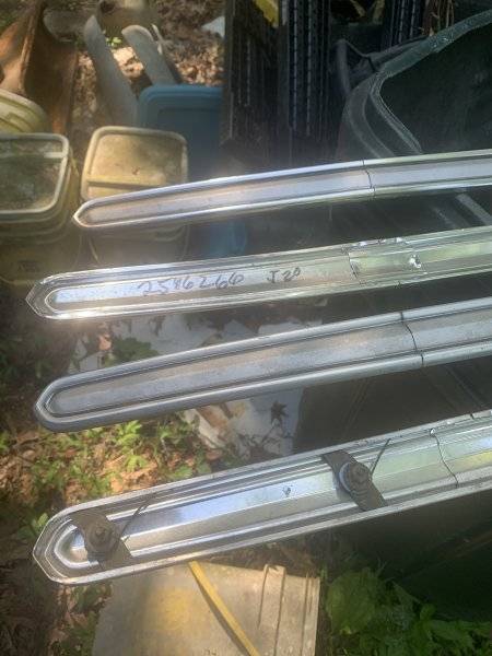

I checked mine (Jan build) original and nos, both stamped aluminum. I guess there was a lot of changes after Dec
