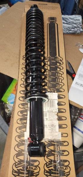

The shocks I posted in (#3), will give you about 3/4" lift and a smooth ride. Monroe also has a very good coil over shock that will achieve the same results. As you stated you already have new springs, I see no problem.
