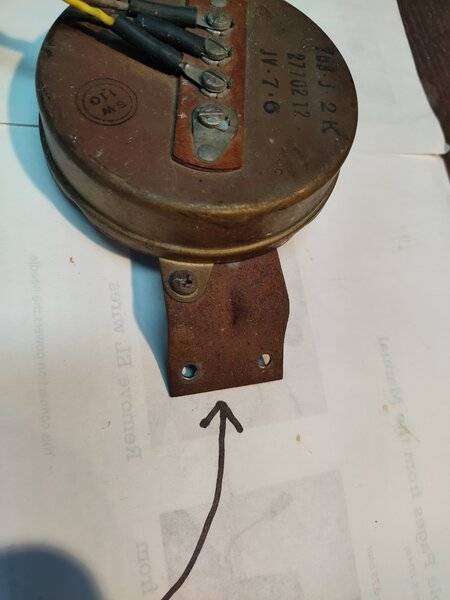

1966 Charger tach. sending unit?
The tach sending unit bracket mounts to the forward edge of the dash frame under the glovebox. It sits right next to the EL powerpack bracket. Once you remove the glovebox it will be easy to see where they mount.

The tach. unit on my 66 Charger is behind the glove box -- on a ledge just below the glovebox.
Story is 66 is behind the glove box. 67 in the forward part of the console. ???
