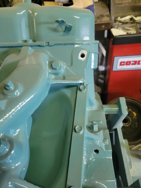

Is there a ground wire from the engine to the body on a 66 Coronet 361? It would make sense that there is one, but where's the location of this ground wire? The battery ground goes to the intake bolt, driver's front. Anyone have an idea or was there ever even one on it? Thanks in advance.
Yes it had one running from passenger rear intake bolt to the firewall near ballast and volt regulator.
It was bolted directly to the head with a special short bolt
Don't believe the battery ground went to an intake bolt, should be cyl head.
3/8x16 intake mounting Bolt through the intake into the cylinder head. One of the 8 holding the intake on.
The body ground on both of my 66's is on the rear vertical part of the passenger side head.-

I bought a negative cable with the extra 8 gauge wire on it and attached it to the body, and also put one on the left rear cyl head to the firewall next to the voltage regulator. I know thats not "correct" but I think these cars need more ground bonding, you cant have too much.
On a BB, the back end of the passenger side head has no bolt holes.
I don’t know the correct location of where the body ground was attached to the engine for the OP’s car, but I would have guessed the “extra” bolt hole on the intake surface of the head would be a logical place.
Sorry I worded that incorrectly.
flat surface of pass side head to firewall. just to the right and slightly above the heater hose fitting ( as looking from the front )
After having a friend have a issue of there parking brake cable glowing when cranking, I have added extra ground wires around the motor mounts to frame. Hard to see and also works well. When I had the battery in the trunk ran extra cable to transmission ear near starter. That one is harder to hide. Stock was above mentioned cable.
