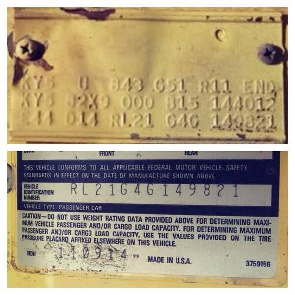

1966 Fender tag decoding
No, it was the 8,855th car off the line that year. All Chrysler plants started the yearly numbering system with 100001. Ignore the leading "1" to get the correct number of vehicles each year.

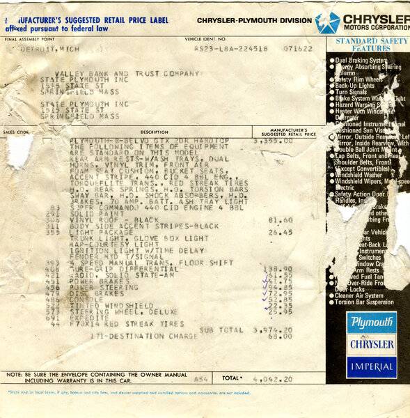

.......and special ordered cars usually had option 691Expedite at the bottom of the Monroney label. That meant get it here yesterday instead of the normal 4 to 6 weeks for a normal sit-down-and-order-it car. That's how I got mine in just over 2 weeks when I ordered it.
No...VINs are unrelated to production meaning it is not possible to know in what order a car came off the line. We know this concept too be true by the MDH stickers not matching with SPDs by days or weeks. (see below)
It is not logical nor efficient to build cars in order. VINs are nothing more than assigning a number to a car; they are not related to production. One would not hold up a production line simply because one car was waiting on a low volume paint to arrive at the factory.
Special Ordered is often confused with Ordered. It was far more common to sit down and check off boxes on an order sheet than it is today. Ordered simply means someone sat down the the order sheet and ordered the car. Expedite means the car takes precedence over a sales bank car as it's an Ordered car.
Special Ordered means something outside normal production:
"I want a color not normally available for this car."
"This is how we need 100 state patrol cars equipped."
"Our fleet cars need to be painted in our corporate colors."
Production time for any one vehicle is contingent on many factors not necessarily whether the car is Ordered or not.

691 is the code for a dealer executive order. The description says Expedite. Turnaround (in 1968) for this type of order was a 2 week delivery.
Normal orders took 4 to 6 weeks at the time.

Car delivered in 2 weeks and it wasn't even built when I ordered it.

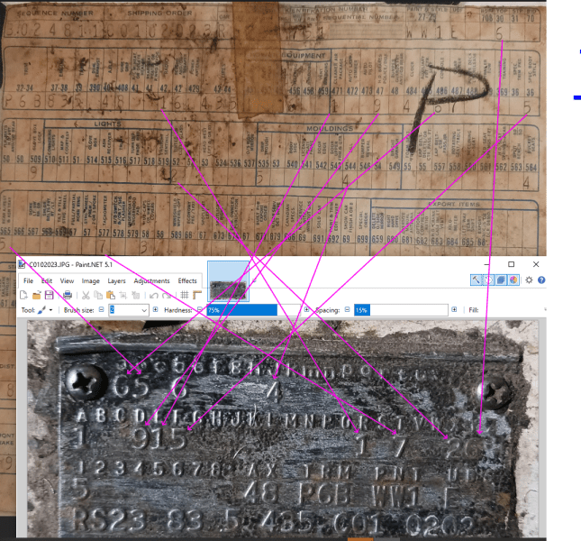

I'm not sure how this old thread just showed up for me again but here's an image showing how the broadcast sheet codes relate to the fender tag for a 1967 GTX from St. Louis to help with the questions around the D8 and D9 codes.
There is a 479 on the sheet for disc brakes and a D9 on the tag for this car in my image. And there's really no other "9" to pull from the broadcast sheet to put under the D except for the glove box lock, and that doesn't make sense. I have another GTX example just like this but from Lynch Road (479 and D9) and lots of examples of Hamtramck Chargers with disc brakes as well with those two codes.
Switching to code 478, I found several broadcast sheets from 1967 with the 478 HD Drum Brakes for Chargers at Hamtramck, but nothing under the D on the tag. I have seen where different plants choose to put different things on the tags and it can even change mid-year at the same plant. I'd still suspect if we found a punch card or broadcast sheet for a fender tag car with D8 that it would have code 478, even if not all of the 478 cars had that on the tag.
Chrysler tried to use the same letter to represent a single spot on the broadcast sheet. So for example X1 = 521 and X2 = 522, but the broadcast sheet would only show space 52 with either a 1 or a 2 under. It, hence the reasoning that D8 = 478 and D9 = 479, even if not all the cars got it represented on the tag that way at every plant.
My thoughts and reasoning anyway.
