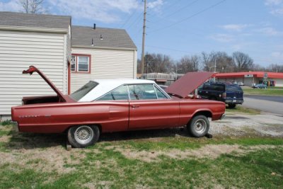

1967 Coronet 500
Great project car! thanks for the pictures..
Not worried at all about the numbers matching. What I'm looking for is a car that I can do most of the work on just for fun and that will turn out as a decent driver.
1800 smackers aint the price level where I am worried about numbers matchin this, how many of what that, how many did they make blah blah blah.....bullshit bullshit............at 1800 bucks, you need to be worried about solid frame rails, solid torsion bar mounts, how much sheet metal work the car needs, how much mechanical it needs, what it will take to make it a good car. Cause unless somebody's real STUPID, you ain't gonna get a numbers matchin low production car for that kinda money. So, rather than try to find out pointless BS, you should concern yourself with more important things. JMHO.
Second one sounds like a much better deal.
YY1 I tend to find 66 parts way more often then 67...go figure. I still have a 66 pass fender but its not rust free....ill make a deal i want it gone.
I found yet another one that might be worth looking at. A 440 model with no engine pictures look pretty good $2250
A 383 4 speed 66 500 is sorta rare, but the body on that last one looks quite a bit better.

What is the original engine in that 440?
Notice the lower trim is missing.
That means there's at least enough body work to fill in those holes.
The ad didn't say and I haven't contacted them yet (been real busy the last few days). If it was a 318, is it a lot of trouble dropping in a 383/440? A 340/360 would drop right in. I'm sure that it has been done, but maybe a modern hemi might be in order. What kind of issues would I encounter doing that?
