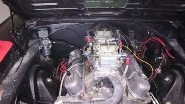

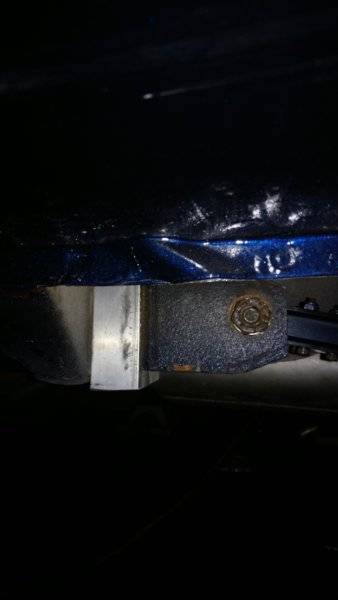

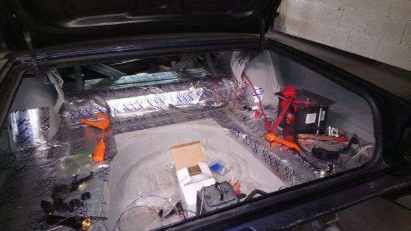

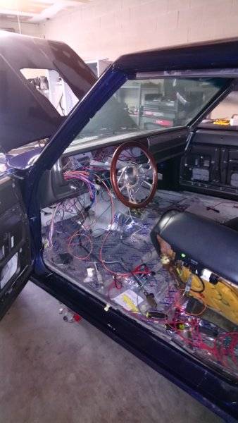

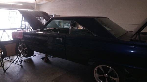

Here are some more progress photos. Wiring in progress, got one door closing now. Battery rolocated, most the sound deadener in. Valve cover remote breather installed.

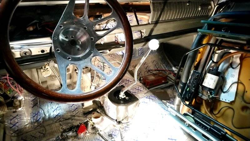

Decided to go with an 833 since I got a good deal on a clean unit out of a 67 Belve, finished installing the tunnel a few weeks back. Probably doesn't need it but going to throw a set of seals and bearings in it before install. Ordered the American power train hydraulic conversion kit last week.
Fab'ed up some seat brackets but need to make some adjustments before final fitment.

Finished installation of sound deadner pads on the passenger and roof of the car so now i can get the headliner in.

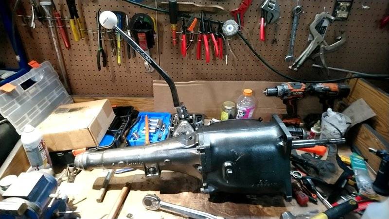

Rebuilt the trans over the holidays and got her installed. I start the rear end rebuild tomorrow. Picked up some 355 gears and a trutrac.

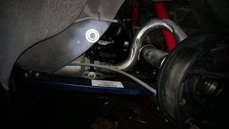

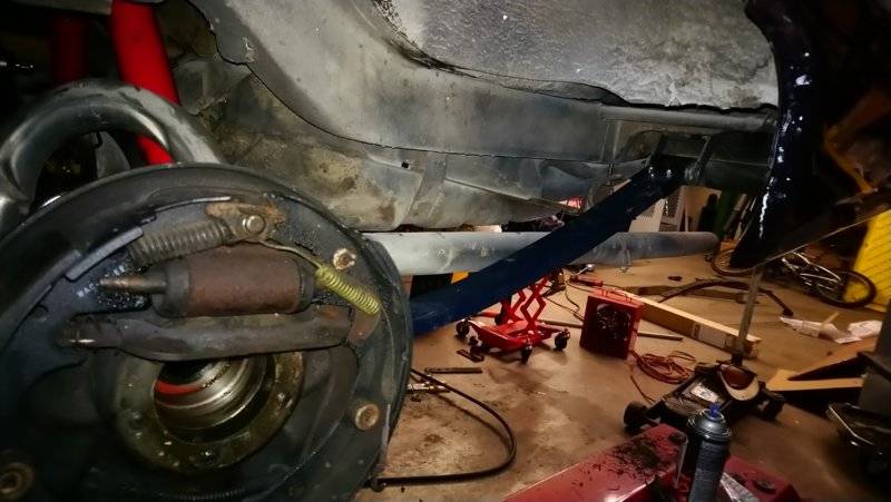

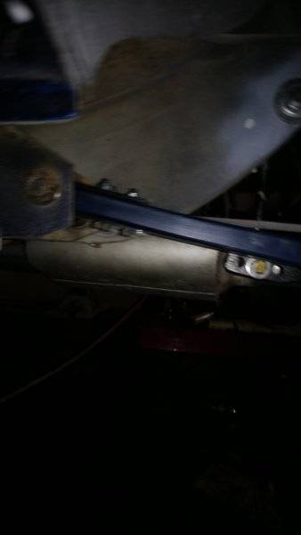

Some pics of hyperco composite leafs mounted on my car. Also installed new trutrac center section with 355s and a panhard bar.

Looking good, still blocking mine..are you going to Pate again next month? Well be in the same place if you get a chance to stop by!
I was looking the other day for info on it. The website was down. I will probably go again if I can get a spot.
Last weekend in April.... I imagine you can still get a spot...might be at the bottom of the hill though..
