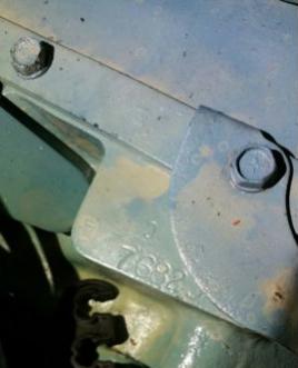

They sent me this pic of the engine block stamping. They claim the last # is a 5. Does this help any?

I don't know what that is. The pad should show a letter C then 440. If HP you will see HP. then, a day/month.ie: 9/1 would be sept 1 66. 1/5 would be 5 Jan 1967. sometimes you will see a 10 or 20, referring to specs on the engine. But that four digit looks a lot like a mid 70's number. ask for a picture of the Harmonic balancer, and where the radiator outlet is.
The casting number on the side of the block is a logical request as well. It is easy to see,,,,,,,,,

based on that picture it would be difficult to convince anyone that engine is original to that car.........
I'm not saying anything here, but I saw those four digit numbers one other time, and that engine was from a police Impound lot.
I could be totally wrong here though. Boots on the ground as 69coronetrt said.
