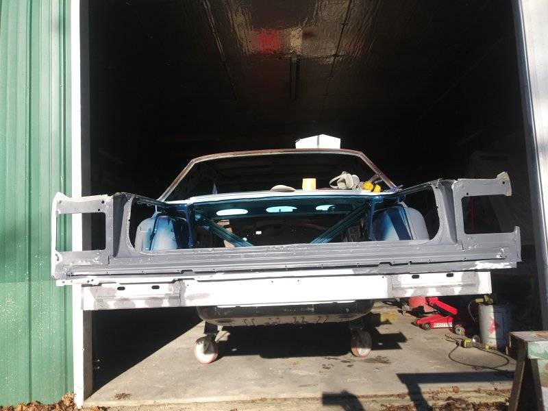

do they make a rear valance filler or rear deck filler what ever it is called. ties the frame rails together in the rear. who sells them ? part # ?
are you talking about the dutch panel? Below the back window. Take a pic of what you need and start a WTB thread. You might get lucky.
no behind the bumper ties in the rear frame rails lower valance. i will try wtb
its called a rear cross member........ prob the same 66-70
nope........68-70 have holes for filler neck and gas tank straps, but likely fit with modification
nevermind, 66-7 also require a slightly curved area on the lower flange to allow for the spare tire well.......... so probably not worth the aggravation
yes that is the one. how hard is it to put on. just need to take the bumper off ?
drill the welds off the thicker plates, and remove them...... there may be mig welds on the edges also.......
then you can access the spot welds to the frame rails...... the trunk pan wraps over the top, you need to attack those welds too...... and the little filler brackets on the side
I saved the one above, you may need to do the same
