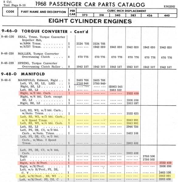

The driverside HP manifold will not be correct for B-E body, but maybe it fits anyway? The rear-dump B-E HP manifold seems to fit some C-body installations.

Specific applications vary but there are 383-2bbl and 383-4bbl exhaust manifolds. The '68 383-4 used the same exhaust manifolds as the 440-4bbl HP whether they were 330 or 335 horse. There are no 383 HP 335 horse specifc exhaust manifolds.
