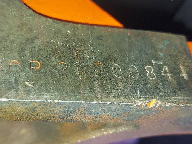

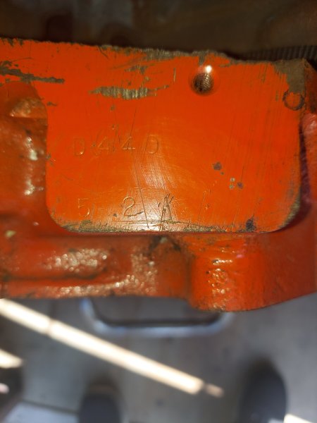

I have a 1968 440 block. Has "D 440" and "5 2" stamped on the pad infront of the intake, can't see any sign of "HP" stamping and it has this number stamped by the oil pan "PT4400P24700841"????? Can anyone tell me anything about this number? Thanks
The pt may stand for police/taxi. The other p may stand for points according to books the rest is vehicle I’d number to match to vin
PT stands for Trenton engine assembly plant. 440 is engine size. P is for premium fuel.2470 is 10,000 day calendar date for may 2nd 1968. 0841 stands for 841st engine built that day. The numbers have nothing to do with the car's VIN. The partial VIN will be stamped on the back of the block to the left of the oil sender in 1968, but not all 68 engines had a VIN stamping. In 69 and up it will be on a pad above the oil pan rail on the right side. The top pad stamping D is for 68 model year, and 5 2 is May 2nd assembly date.
