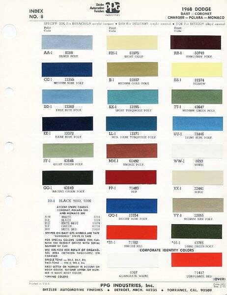

Yes I have. You will notice in the chart that none of the Chargers listed have a "Z" code listed.

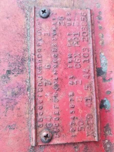

The build sheet shows in the 50 column "Spl Paint Treatment" and inserted is "8" which, I think" we all agree that 508 on RR and GTX was the performance Hood paint for '68. But notice the block is labeled "Spl Paint Treatment" and is not specific to the hood.
COULD the "Spl Paint Treatment" block mean something related to the treatment of the painting of the car such as a process for cars to be displayed by the Mfg. or SOMETHING ELSE unique to that particular Charger.
I know that a 8 under the B on line 3 of the fender tag is for "Buffed Paint" but just throwing out an idea not an answer.

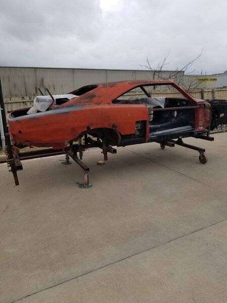

It is defiantly unique that this code is on a Charger.
The mystery continues.
BTW, congratulations on you obtaining the car
great find
