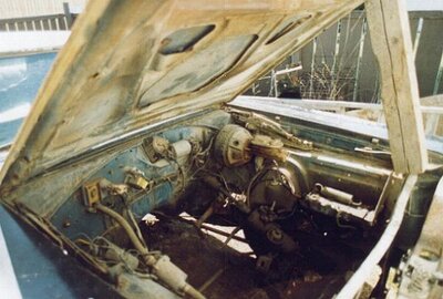

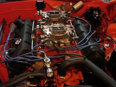

When I built my Hemi Challengers a couple years ago I used a reproduction Hemi Master Cylinder in both of them. They worked great, Sorry I don't have a better photo. The GTX shot shows the booster setup but the M/C attached is not a Hemi one. I don't know if these photos will help you.

What is the red capsule below your master cycl.
It’s a residual pressure valve I installed when chasing a soft pedal. Turns out I had a minor minor weaping/leak at the rear wheel cylinder where the hard line connects. I probably don’t need it but it doesn’t hurt anything now…
