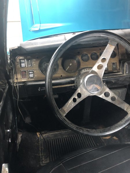

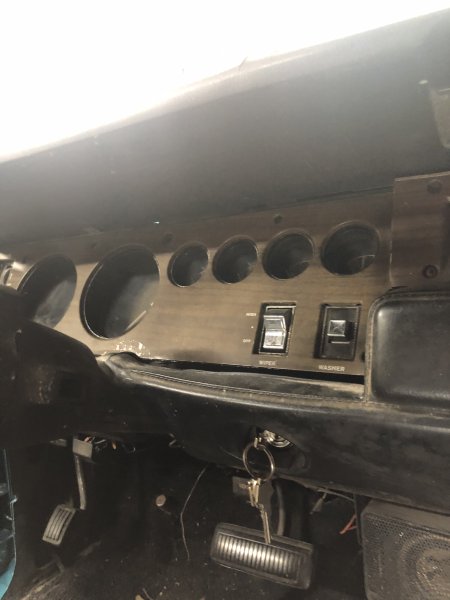

Will a 69 b body charger dash frame fit a 68 roadrunner? I’m converting my 68 roadrunner to ralley guages. The previous owner hacked up the frame in the car. If not I’ll have to splice in the guage mounting part of frame. I appreciate any advice. This is at the end of my list before finishing

I’ll be long gone when it’s sold. The original hacked it up years ago and the ralley guages are loose in a large hole. Original cluster and bench seat gone so I’m going to make the best of it
