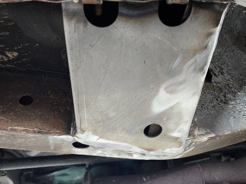

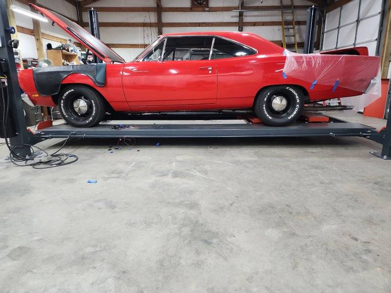

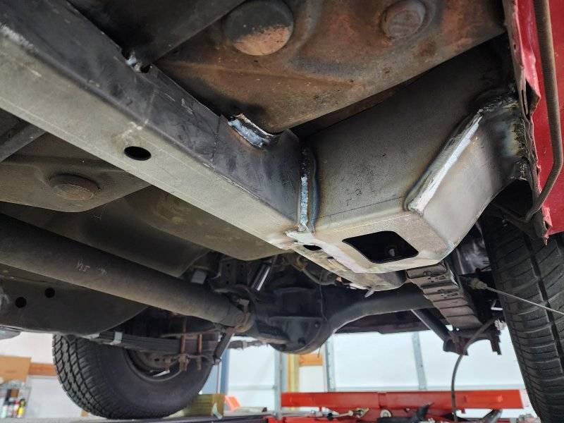

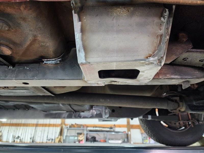

Progress continues, have the frame connections in and all 4 boxes in. All info I am getting is to go with qa1 4 link rear and qa1 complete suspension for front. What is your thoughts on a Dana 60 rear end 2 inch shortened for the mini tubs, what gear? With Hellcat and HP90 transmission.
