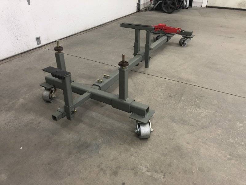

I think US Car Tool sells the stand you want. They're simple to build - if you have the tools and equipment.
Thats the link I posted. They have a lot of G3 conversion parts.

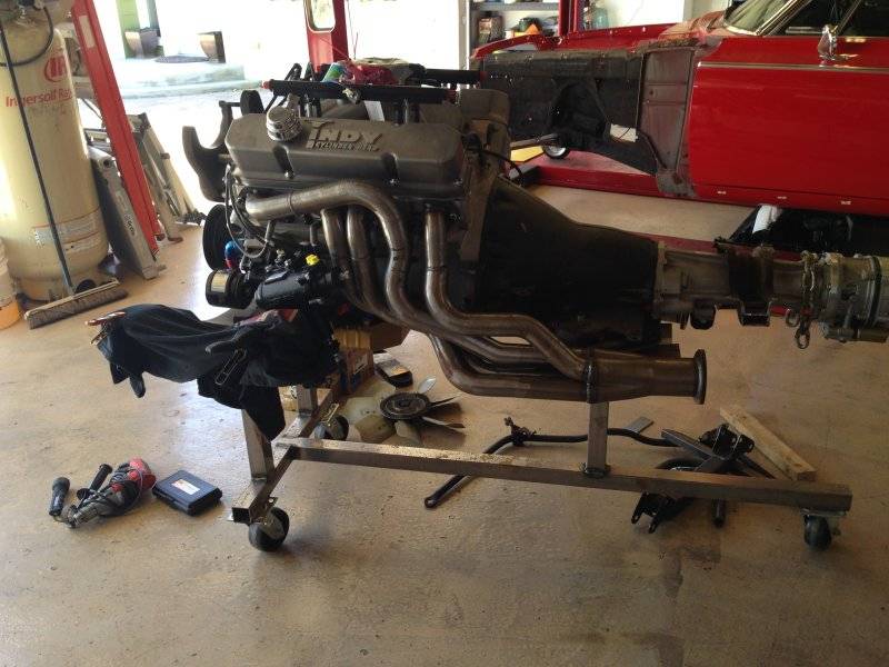

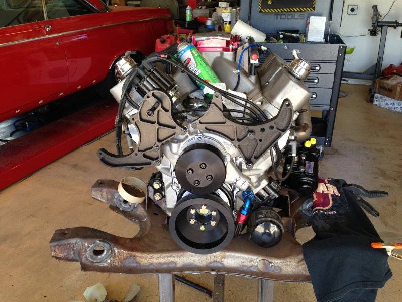

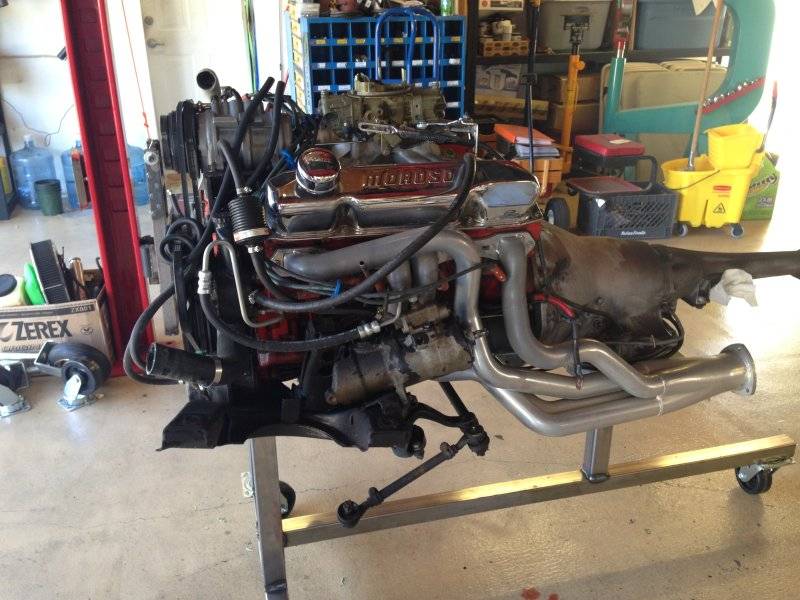

If you are handy with fabbing, make your own. Here's mine for a oe k-frame. Many ideas out there. To align the K with the cart, I got some 5/8x12" bolts. Cut the heads off and had the ends tapered down to help get it aligned.
This is a fabulous idea and exactly what I am looking for. Thank you for taking the time to share with me. Do you have time to talk on the phone? If so please dm a number and time to call. Marlin

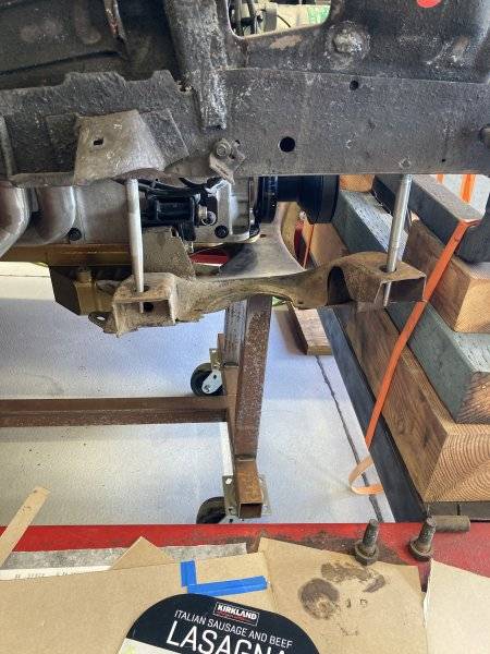

If and when you build it, keep in mind the engine and trans sit at an angle. If the car is level on the hoist and so is the engine then the trans cross member hits first and you can't get the k bolts in. Make the back lower or adjustable. If everything is good it's a one man job and an hour or less. Preparation is key.
Those guide pins are a great idea! Think I will have to make a set.

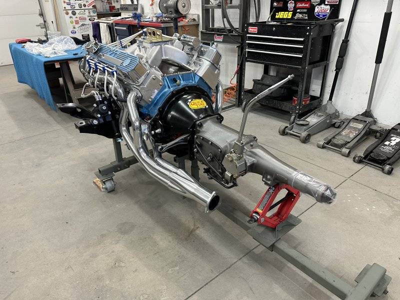

Tons of info on here on how to build one. Only way to install a Mopar engine and tranny in my opinion.
Good idea with the jack at the rear. Ideally you want the crossmember bolted on as well.
