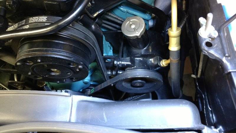

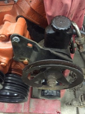

well i don't see that at all . but you do what you think is right , maybe some more pics of vehicles with a/c and p/s would be a benefit . this is what i ran with a/c n ps . the last pic , is what i run with ps , View attachment 583651 View attachment 583652 View attachment 583654 View attachment 583656 without a/c .

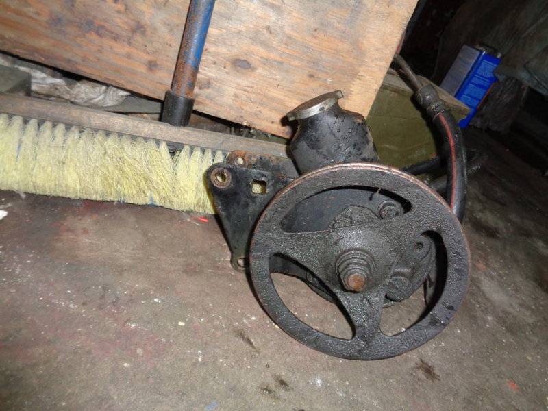

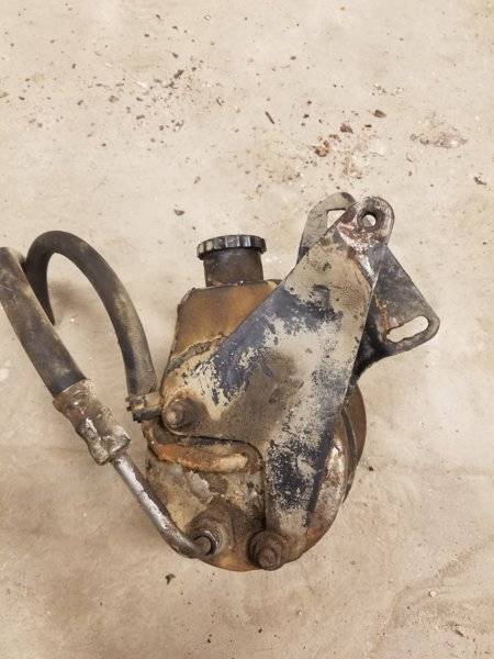

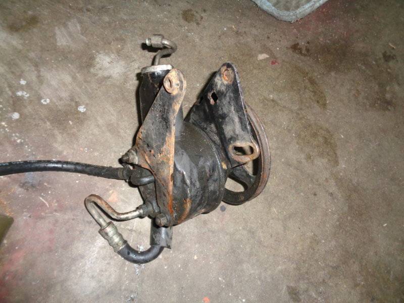

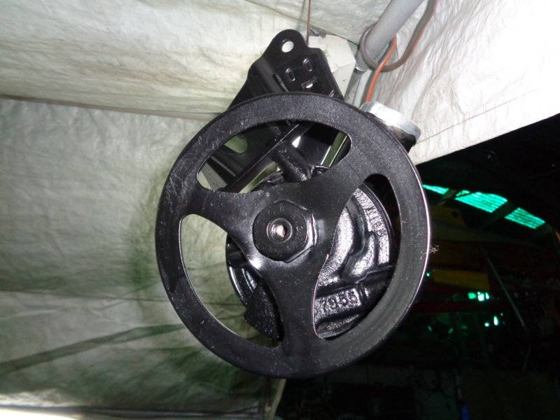

This is the pump I got. As can be seen in photo 4 it won't fit a 440.
It's got different pulley and brackets as yours.

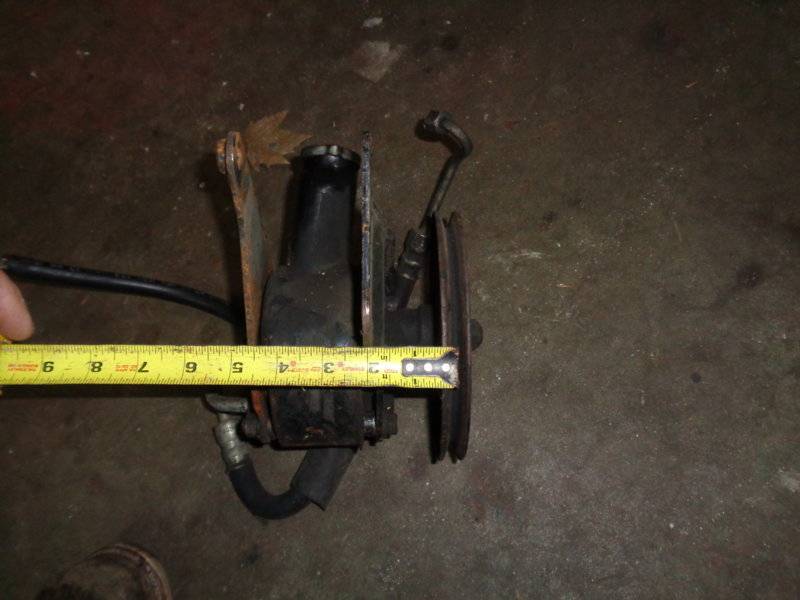

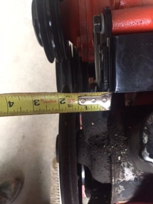

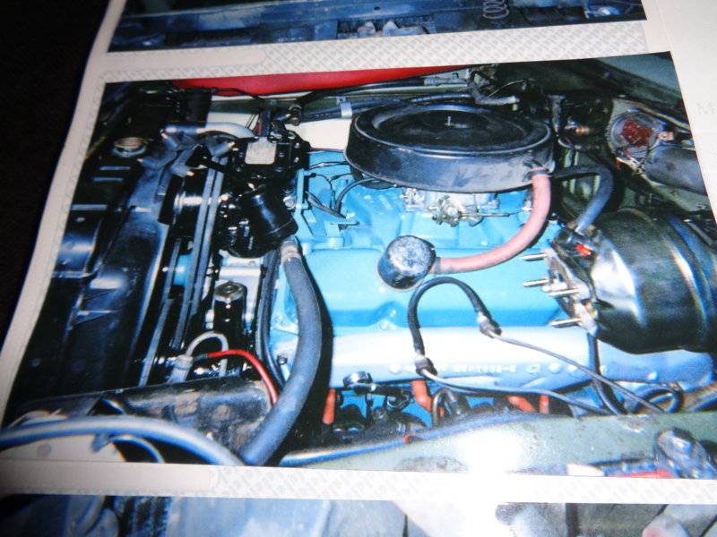

the one in the pic is from a 383 a/c ps in a 68 dodge polara 500 . and the 69 dart ps hose , was very close ot the exhaust manifold . what does your measure from the bracket to the pulley ? your front bracket looks like it has more bend in it .
If you need to have pulley closer to pump and not by much, you can remove pulley and have it trimmed down the appropriate distance and reinstall. Using correct pulley tools. There are different pulleys and no part numbers on them so you really do have to have an example of what would have been on the car.
Thanks for your reply, I need to go away from the pump about 1/2 inch!!

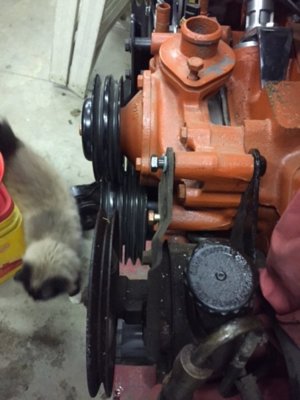

Good luck you will get it. I have to get everything from water pump out. My engine is from a rv and water pump housing different from a car.
4 3/4" O.D. It's also the same pulley that was on my (previous)1968 Hemi cars & 1968 383 car that had power steering.

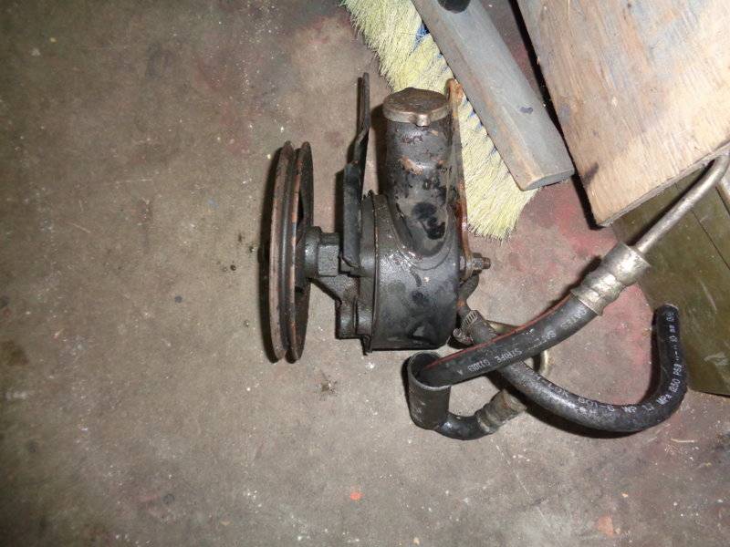

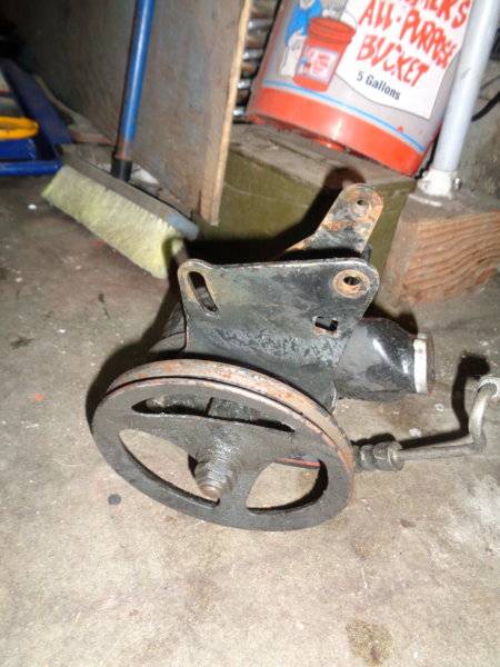

Update, I got a couple of test pumps from a mopar nut at the mill. One of the pumps seems to match the pump that Pomonamissel (that is a long name!) recommended. I put it on and it looks like it will line-up. Still confused a little because my reference book (Charger, Road Runner, & Superbee restoration guide by Paul Herd) says that all big blocks in 1969 had Federal pumps and different size belts were used in 1968 - 1971 on AC cars. I guess this means different pulley sizes but that is not clear. I did order an Ebay pulley for the federal pump that may or may not be correct, Ha if you can afford to play with mopars , you can afford a couple of practice parts!! If there is any body out there with a stock 1969 440 with AC I would love to know what is actually on it!
BeeCool, I will post some better pictures this weekend and update you on the federal pump set-up.
