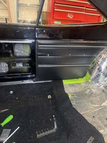

Right or wrong i dont know. I put wind lace in under the sill plate. Placed the extension in next. Flat side toward carpet. Rib toward quarter. Interior panel on after.
