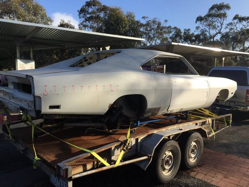

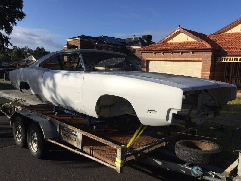

Hello guys and girls this is my 69 rt se charger build i picked this up locally in Australia.It was a one owner numbers matching car the guy that purchased it from the USA had stripped it down to start a full restoration but as we all know it don't always go that smoothly.So i picked it up as a project car after a 10hr road trip she's finally home & so the story begins

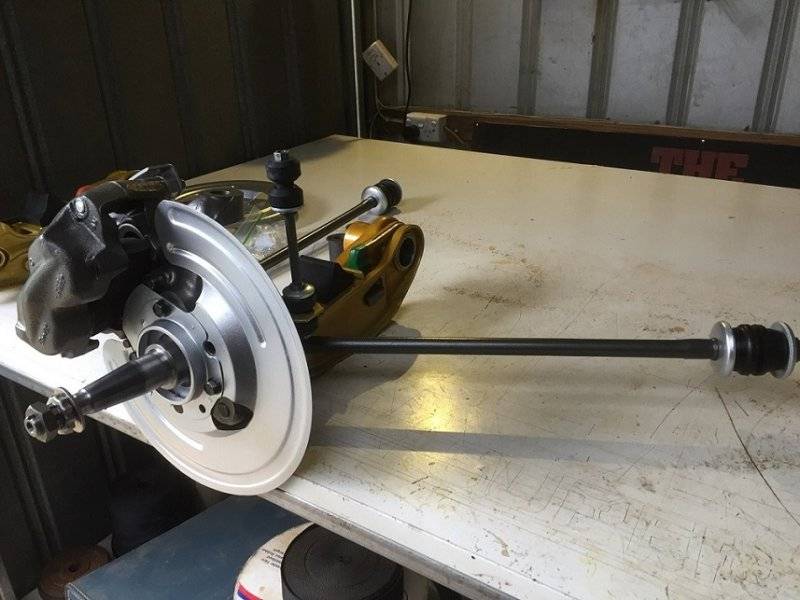

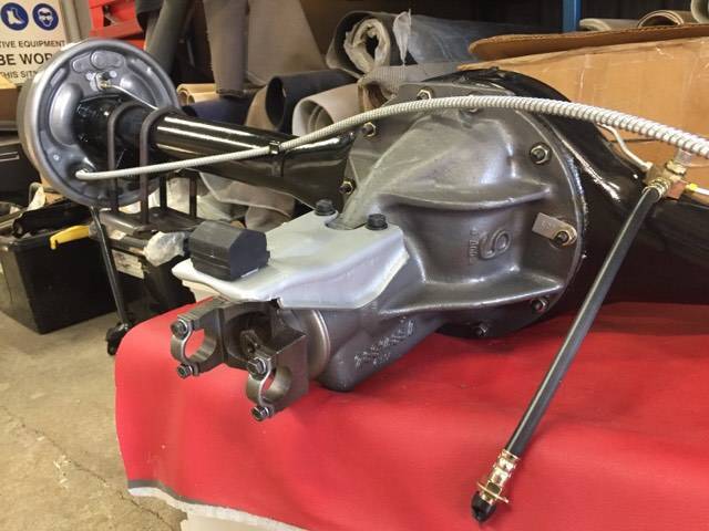

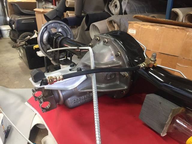

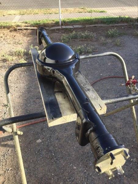

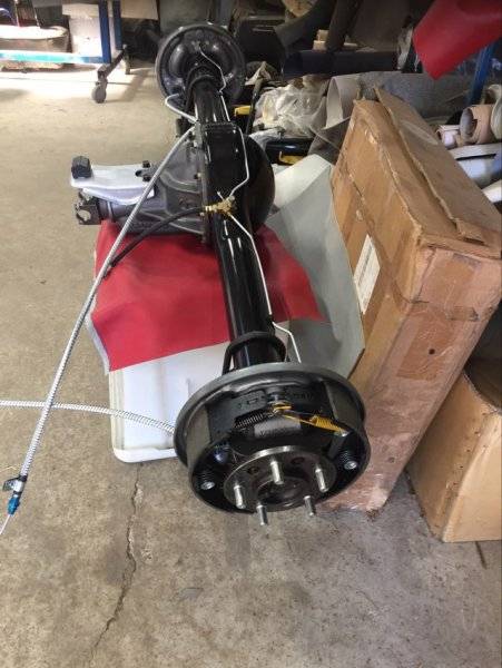

diff pulled down stripped down center removed and painted .then a new eaton tru trac LSD center put in with new bearings and brakes & every other possible part replaced

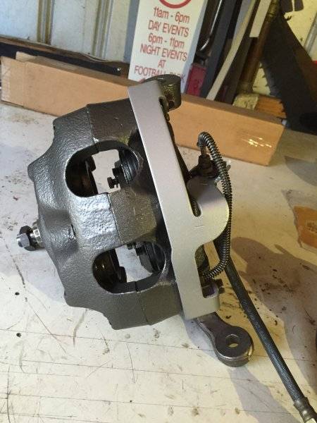

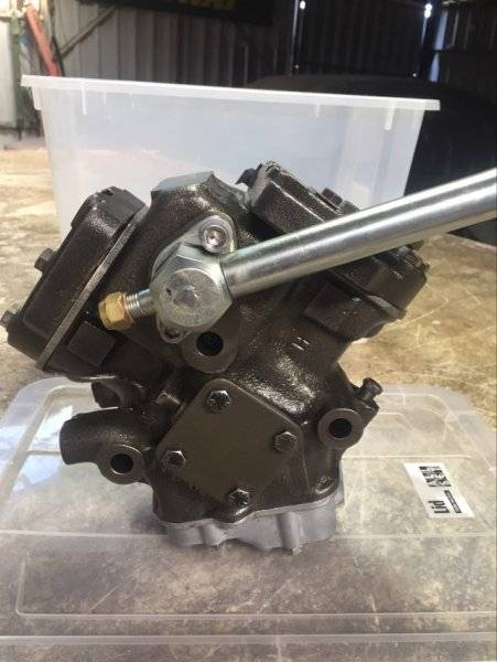

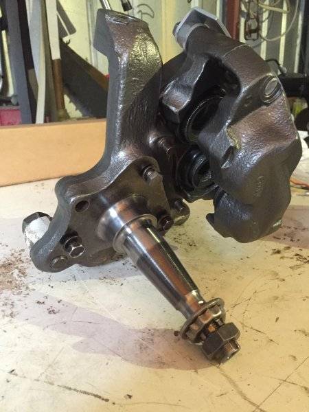

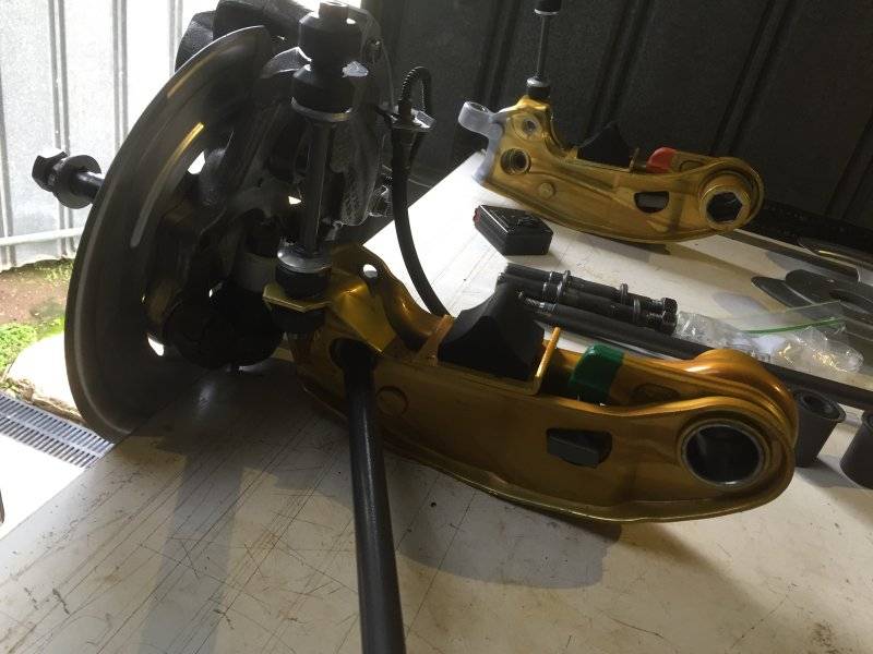

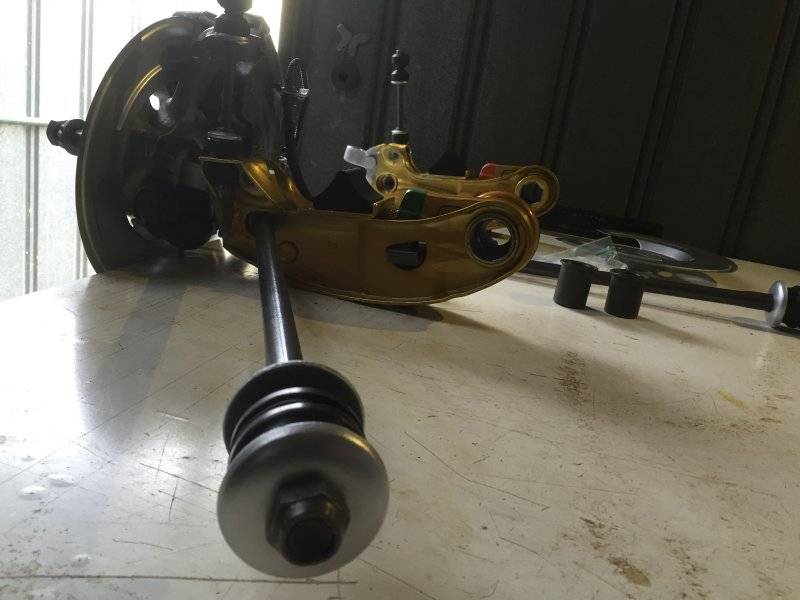

brakes pulled down calipers rebuilt new bearings seals rubbers done painted to replicate as close as possible to original according to my vision

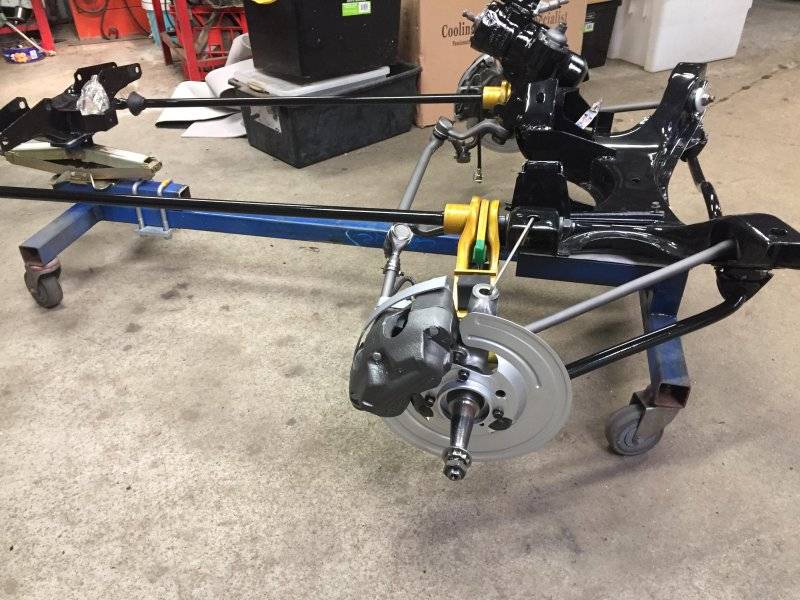

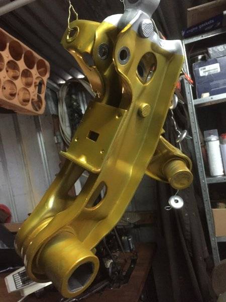

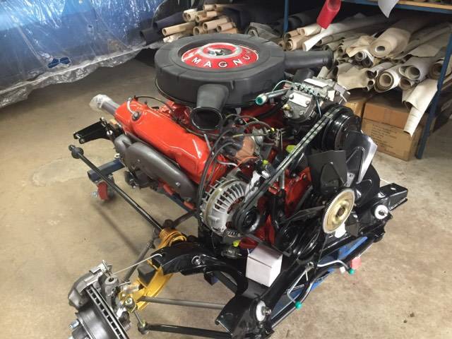

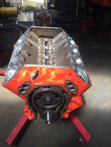

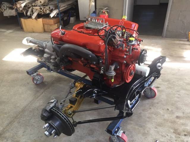

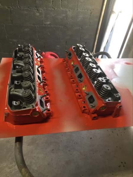

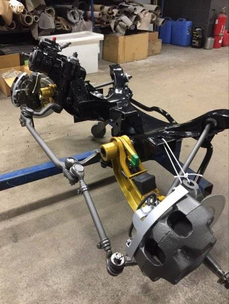

number matching 440 magnum HP engine stripped down & sent of to the mechanic to rebuild it's no race engine by any means just a nice freshen up with a couple of steps up from standard cam balanced and set up for unleaded gas .transmission got the same treatment just a freshen up with a stage 2 trick kit and convertor stepped up to suit cam .the k frame was cleaned up and 2pk paint the all bushes replaced along with all nos ball joints and tie rod ends nothing missed then put together on a cradle ready for assembly.
Here's the cradle i built to mount the drive train on & all the running gear ready to fit to the car

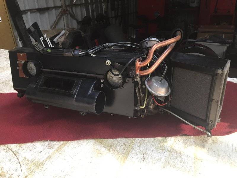

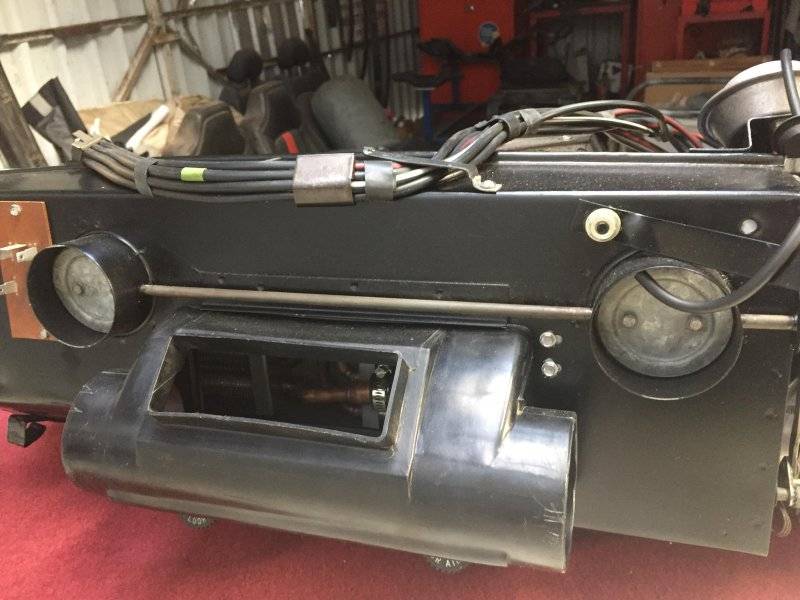

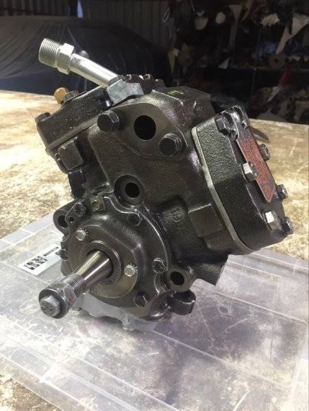

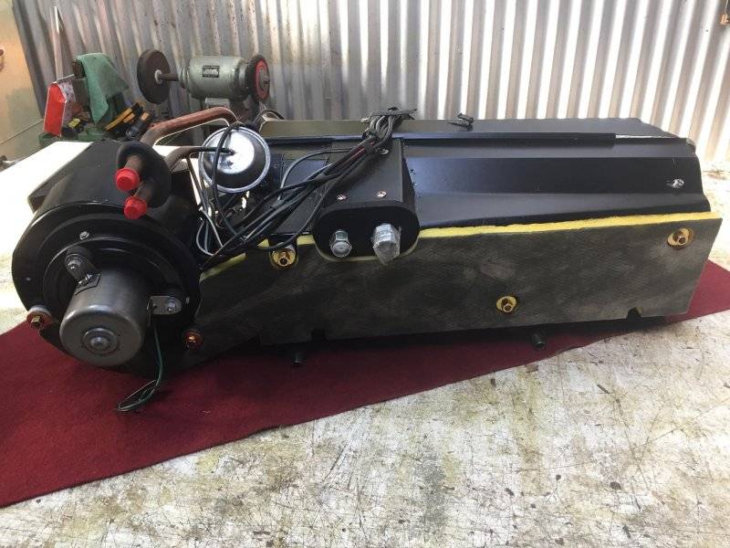

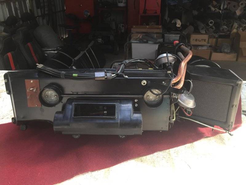

A/C unit rebuilt including the under dash box and i mean rebuilt not just painted i've replaced just about every component with NOS parts pistons crank seals bearings oil pump etc etc would have been easier and cheap to go after market but hey

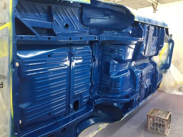

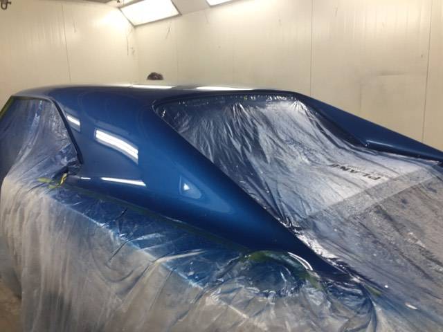

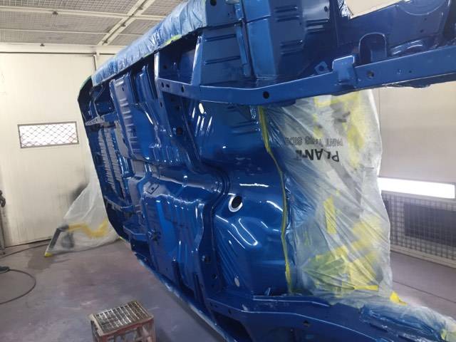

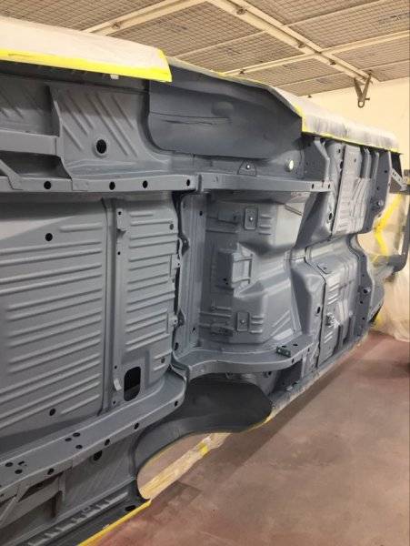

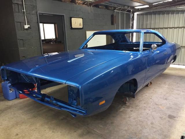

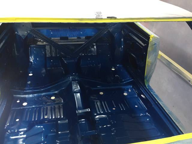

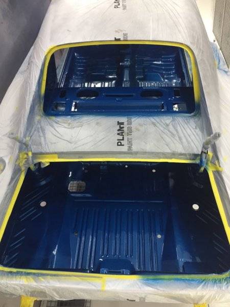

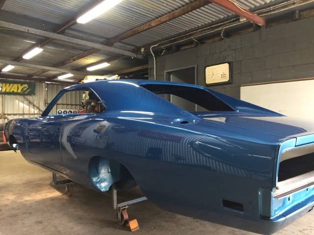

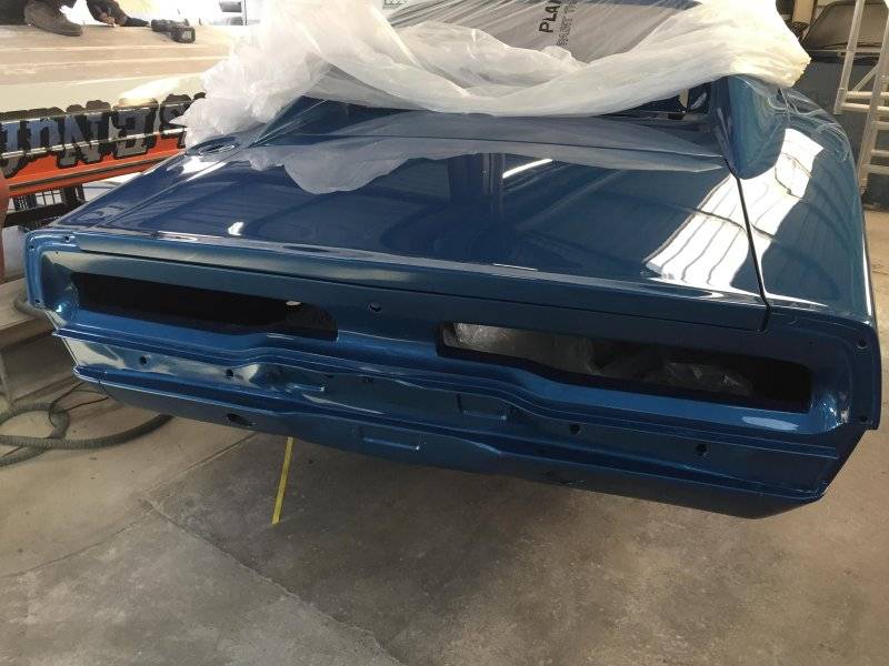

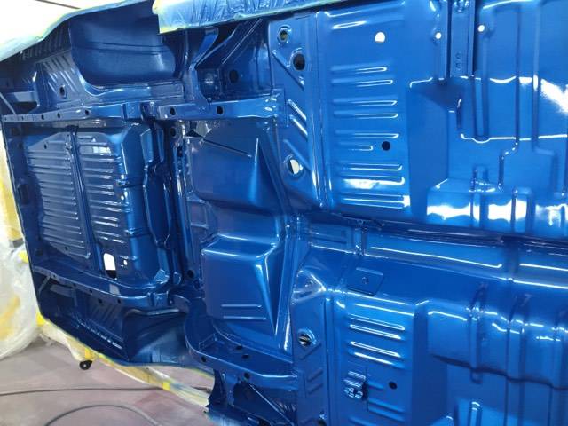

Exciting times the body is finished and the paint is being applied
Nice work, can't imagine what it will look like once you complete it! 440'
Thank you very happy with the out come so far i've only started uploading the build now as i've been to busy to do so up till now so i have heaps of pictures to look through enjoy
