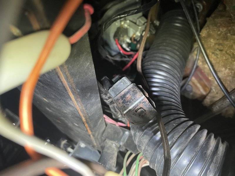

I think I located the regular turn signal flasher. I/'m alittle baffled as the shape of it isn't round and more square. The turn signals flash rapidly. I'm assuming its an unusual flasher that was used causing that?

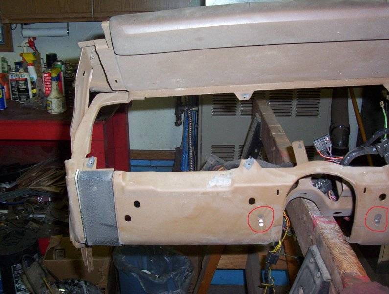

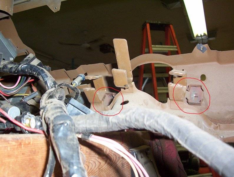

One slot is to the left of the column, the other is just to the left of the ash tray. Located on the inside bottom lip of the dash.
Both located within inches of the steering column.

That square with clip is one of the flasher holders next to the defroster hose. That square relay isn’t it thou. Like your used too, it should be round with blade ends

Hi pnora. I’m pretty sure I located one square flasher with square holder just to the left of the ash tray holder. Can you see it in my picture? I’ve yet to look in the two locations you mentioned to the left and right of the steering column. Was this standard location for all 1969 B Body’s? Thanks

Pictures I posted were from my 69 basicly unmolested Charger when I took it apart to restore.
