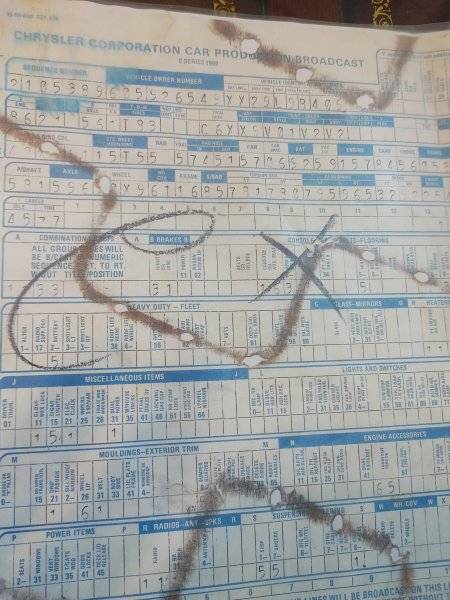

I'm looking for help decoding what was original on my 1969 Daytona. With the number of wheel options I'm getting a little confused what came with this car.
What I know...
Build sheet lists:
Line 2 "Tires" - T83 which show to be 14" Goodyear Speedway red stipe.
Line 4 "Wheel" - either 30/X9, 50/X9 or 90/X9...the spring rust ate through the code, but what's left has to be one of those combos.
Line 4 "WH COV" - 61
Any help is greatly appreciated.
Jim-
*Attached build sheet

I have a 1969 collision parts part number book (See attached pics). Based on this..it looks like it would be the "Chrome Wheel" #2823840?? and below #2944161 trim ring?

68 was only year for full chrome. 69 uses one year only 4 place “gripper” trim ring but 69-up use the better gripper (all around and can use ) better design but purists would kringe if you pop one ring off and not politically correct
So the above pictured "Road Wheel" magnum style with trim ring right? I'll have to start searching for some used OEM wheels...I believe the are 5.5"...most repops seem to be 6" as above yearone ex.

If your code is 30, then they are 5.5" wide, some C body magnums were 6" wide. As stated above they would be the trim ring type.
