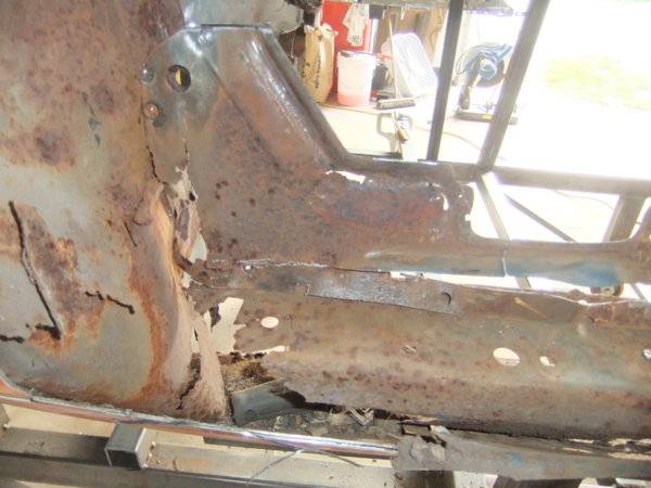

Thanks pat, i've decided i'm going to try and salvage what i have. A few ppl seen them and thought i was just to fussy lol. but i just dont want to see a spec of rust on this car when its done. Mine looked decent from the outside, but it was a different story when i opened them up and was able to see inside.

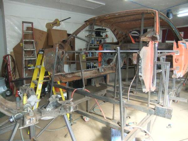

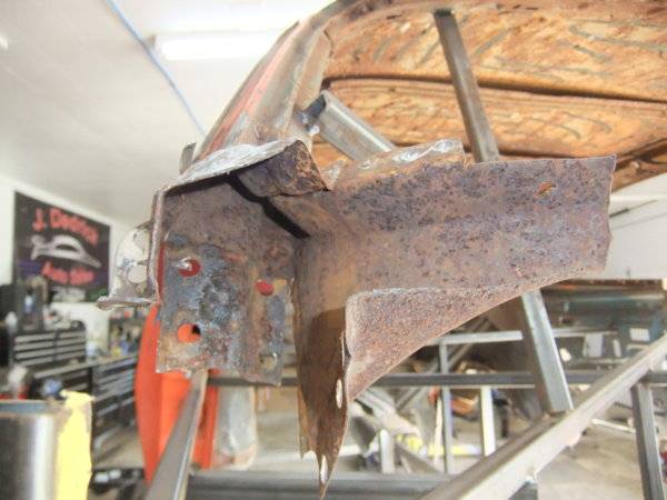

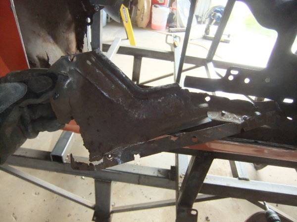

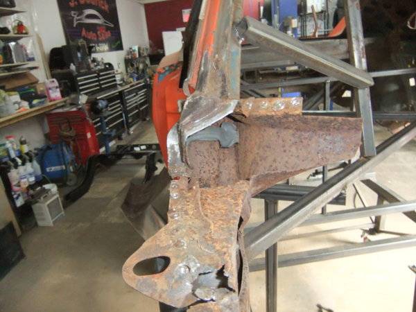

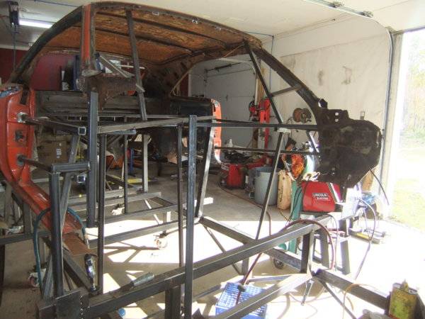

So here was removing the old inner cowl

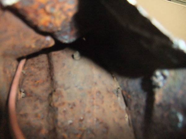

The outside of the a-pillars should clean up nice, but they are fairly rusty up inside which i cannot reach. so we came up with kind of an odd solution.

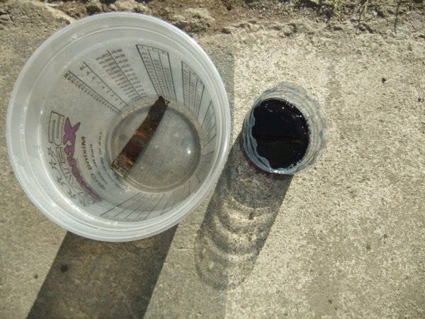

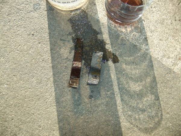

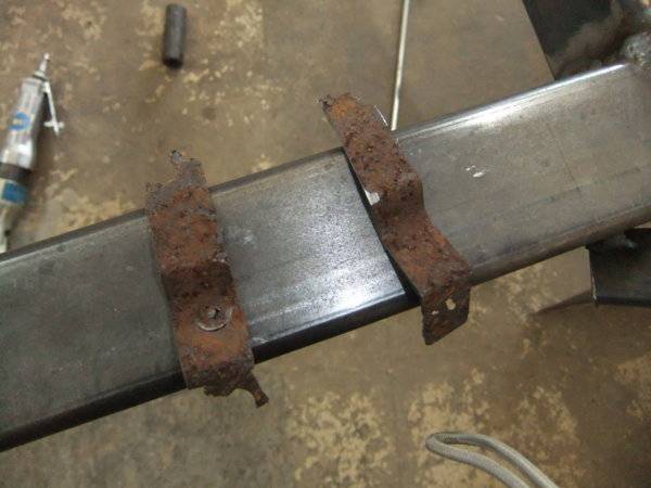

So i took a rusty sample and cut it into 2 pieces and soaked one in vinegar because i heard it will break down the rust, and the other one in wheel acid, because i have a ton of it...
Vinegar would work but it would take a very long time.

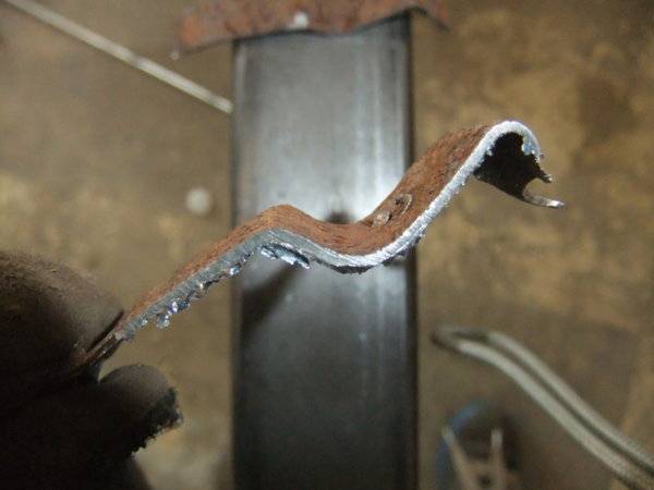

The wheel acid straight(not diluted) literally stripped the rust in about an hour. see picture.
so thats what i want to use. leave over night and it should strip every ounce of rust.
Notice in the pic, even though the metal is very rusty you can see from the side profile that most of the thickness of metal is still very solid/shiny.

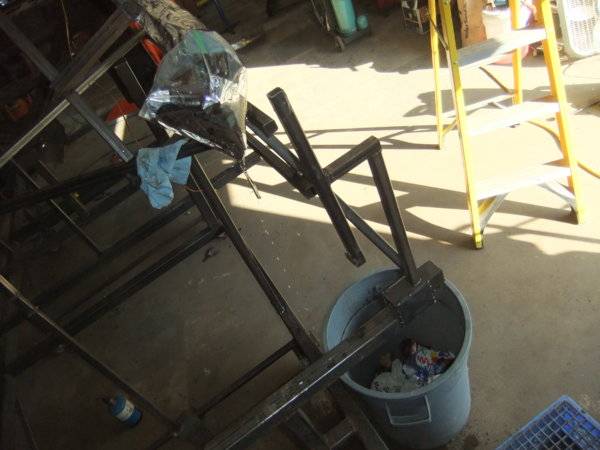

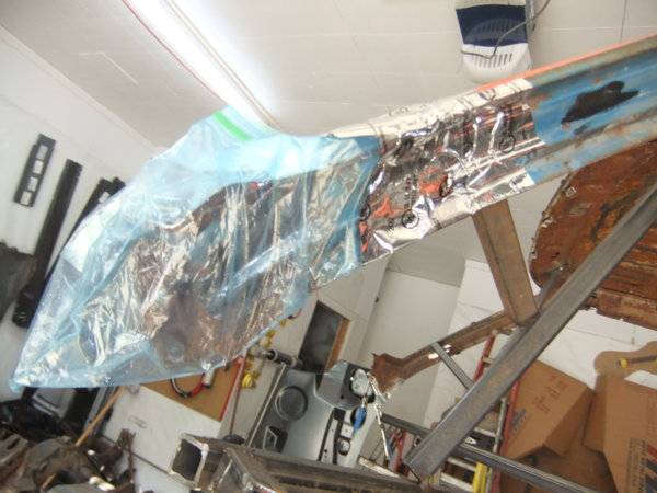

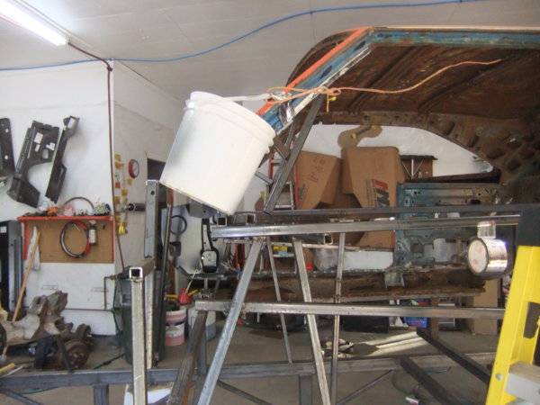

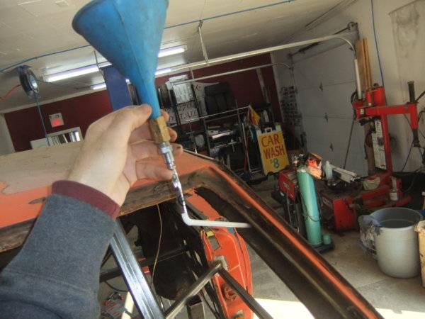

So then came my epic fail...lol tried to bag and seal the end so i could literally fill up the entire a-pillar with acid with a jerry rigged funnel some air fittings and a drinking straw from my lunch. The metal was to sharp and when the bag got heavy it started piercing through.... half a roll of tuck tape later. trying to plug the holes..i admitted defeat. We laughed for the better part of the day from our stupidity and there is still vinegar all over the place.

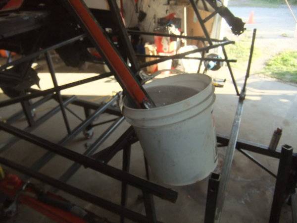

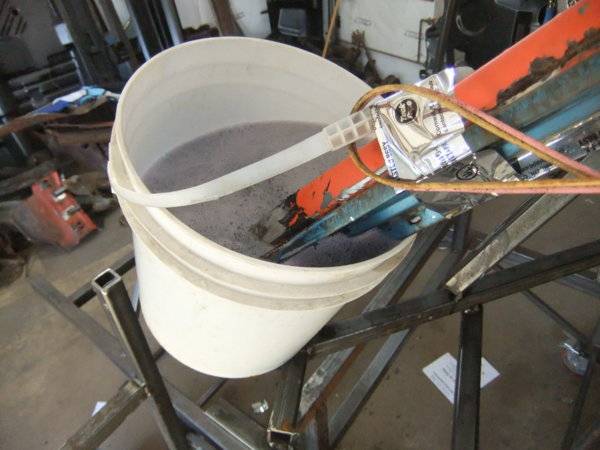

So i just got a bucket and filled it with acid/submerged what i could, to see if its going to work..then i will figure a better way to plug the end and get farther up.

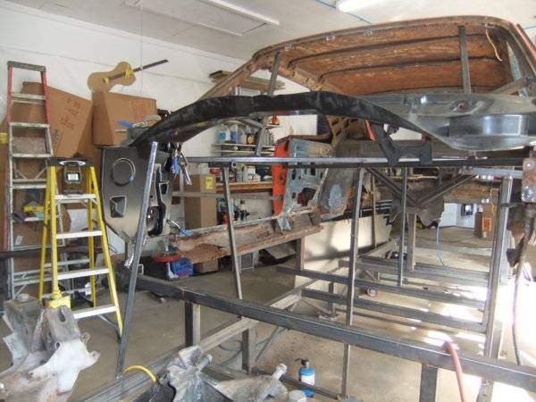

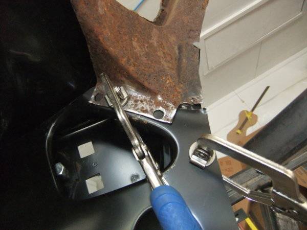

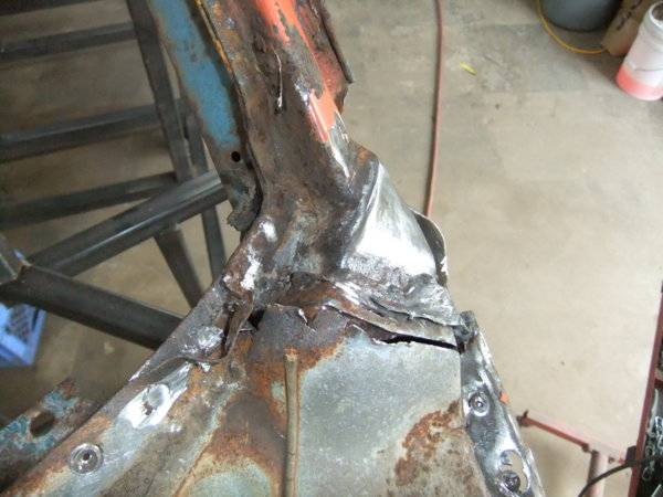

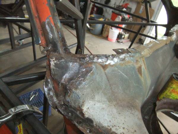

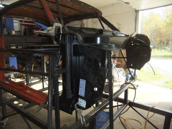

Prior to that, we got the new cowl, Door hinge pillar and right lower cowl mocked up, i'm happy with the fitment after some tweaking. waiting to get the firewall later this week to mock that up again this.
I found it odd that when you have the side cowl on..you cant access the upper bolt for the hinge..ill have to cut a larger opening.

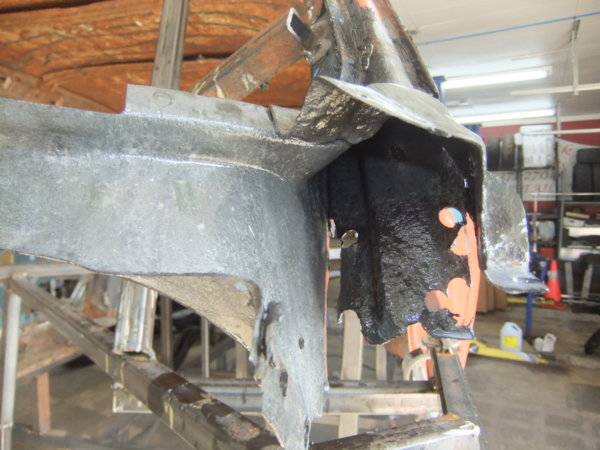

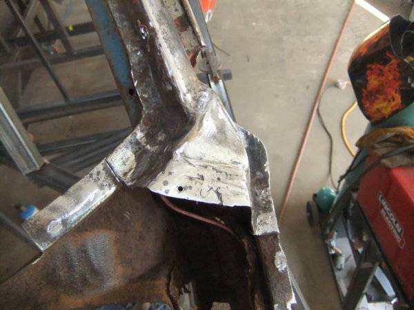

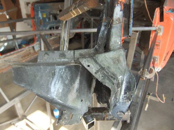

I was very happy with the results from my bucket of wheel acid. it consumed every once of rust...now theres a decent size hole in the pillar though. thinking i can fix it.
I need to come up with an idea of how to essentially plug the end of the A-pillar so i can fill the whole thing up and eliminate any rust inside..anyone have a suggestion of what to plug the end with that the acid won't eat through?
I'm now soaking the other side over night

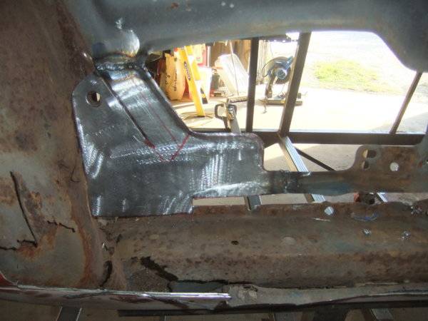

I was able to make up the patch on the other inner panel today as well. The bead roller couldn't put a sharp enough bead on it as i would like, prob cause the metal was maybe a little to thick for it. It turned out okay though...just need put in the lower straight piece.
