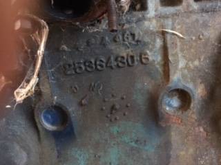

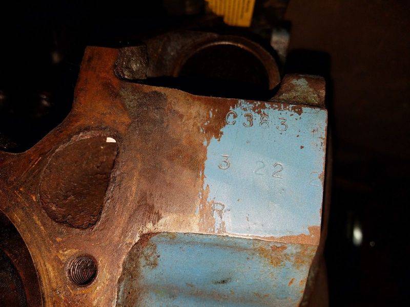

To the left of the distributor is a flat machined area that is stamped and should read "C 383" (C for 67). Near the bottom of the same area if a high performance engine, stamped "HP". Below is an example but of a none HP.I got the numbers off the engine 2536430-6 date 4/67 I looked up those numbers and it appears to be a 440? Is that correct? He told me he thought it was a 383 but now I think he is wrong?
Thank you for the pic. I will post pics after next saturday if the deal works out. I know what to look for now that helped.To the left of the distributor is a flat machined area that is stamped and should read "C 383" (C for 67). Near the bottom of the same area if a high performance engine, stamped "HP". Below is an example but of a none HP.
Yep. Good luck. And just an fyi, that hole just above the stamped area is where the distributor goes.Thank you for the pic. I will post pics after next saturday if the deal works out. I know what to look for now that helped.
