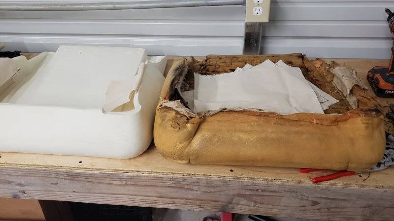

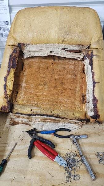

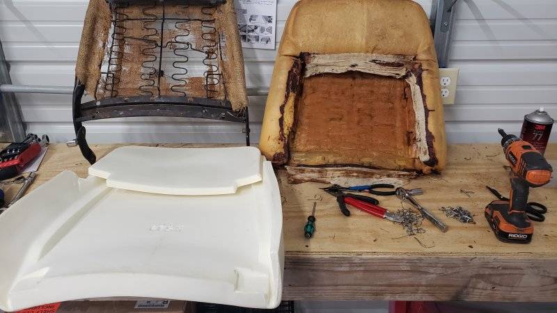

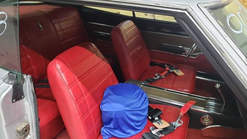

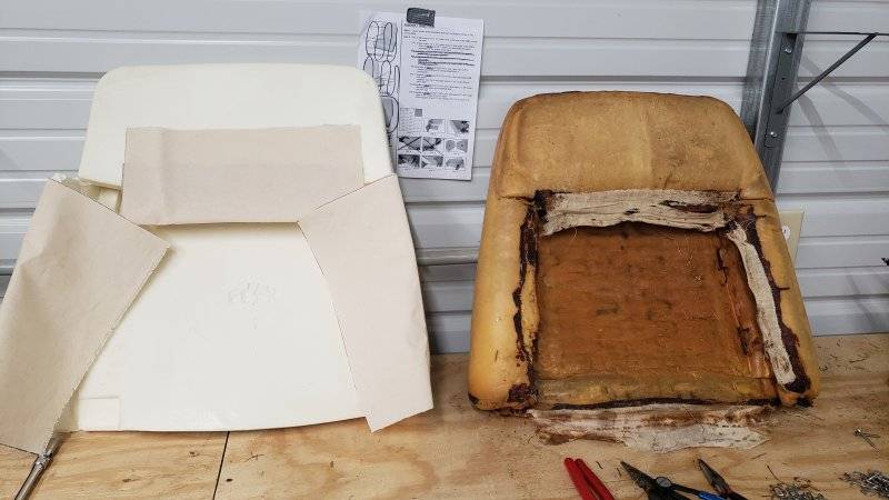

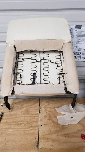

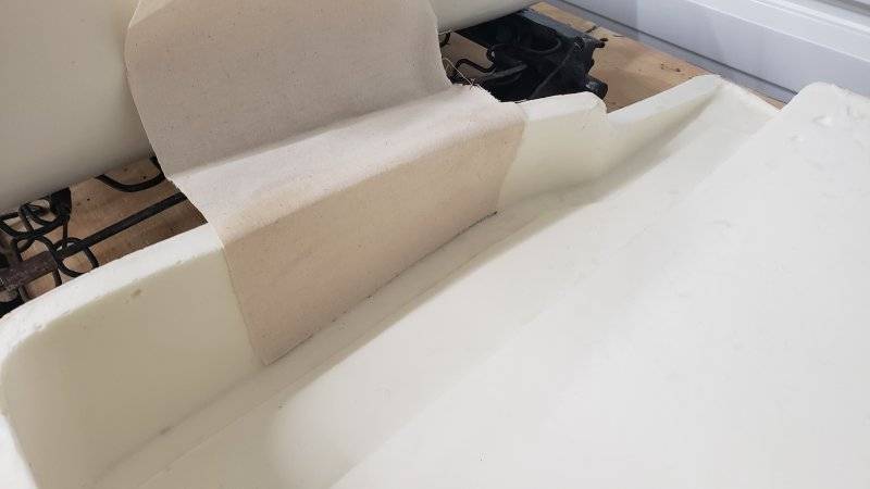

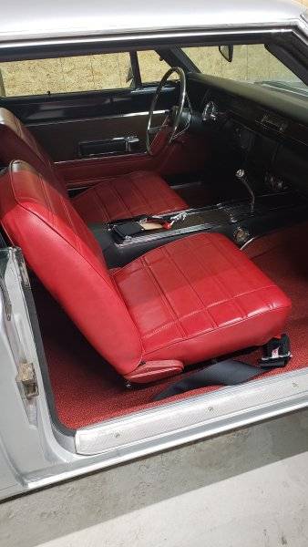

I finally had a chance to work on the seats. The foam from Legendary worked pretty good. The directions made my head hurt so I just copied the original foam where the muslin attaches.
Stripped the old front seats, had to weld up one spring that was broke then started attaching foam.
The foam is so much better than what I had my head now rubs the headliner :)

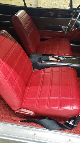

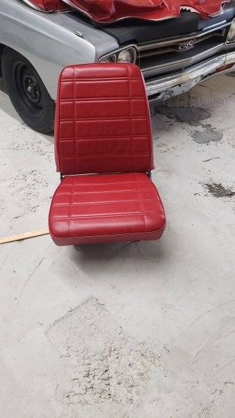

And back in the car. Took me the good part of the day. First project I completed in my new shop. I enjoyed the extra space.

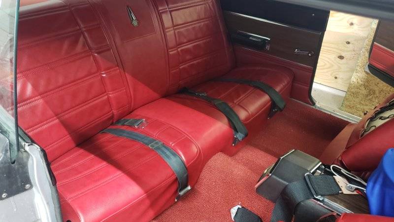

Going to tackle the back seat tomorrow.

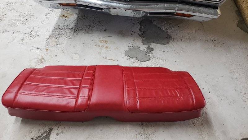

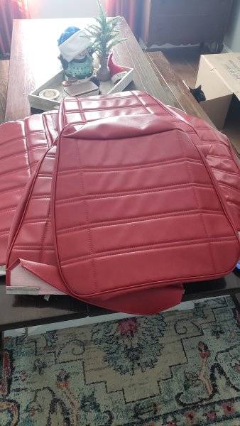

Back seat was way worse than the buckets. Stretching those covers was a huge pain as they were tight. I guess the next step is getting red seat belts for the back and painting the console.

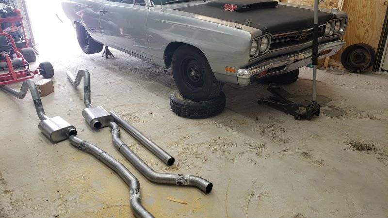

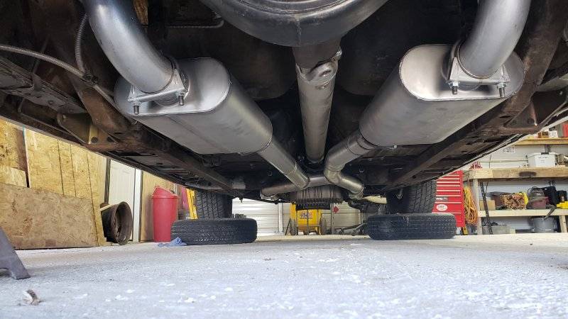

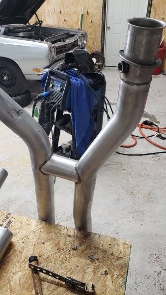

New exhaust for the GTX. 3" kit from Jegs replacing the 2 1/2" and twin Dynomax Ultraflow welded mufflers. It went in pretty well with modifications. Space didn't seem to be an issue but this is not a plug and play kit.
It's a little cramped around the tailpipes isn't it.
Now you need to go to dragstrip again and see if it helped.
Maybe it was because of the Dana 60 & lower stance, but mine was fairly tight fit.
