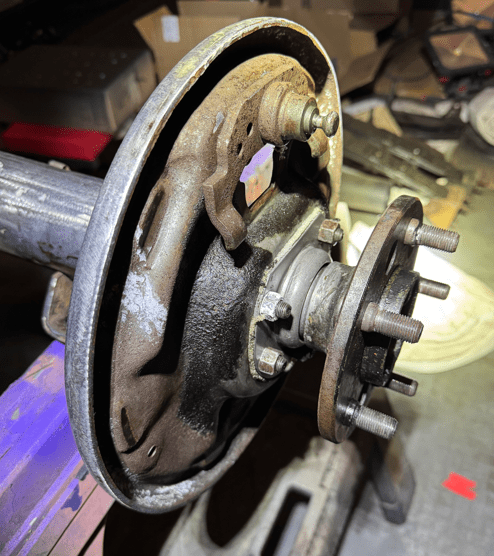

Im restoring the rear end of 1969 8.75 rear. while Im doing this, I need to change out the seals since there is evidence of liquid loss. Any one know any good seal kits to purchase?
Also Im attaching a few photos of rear.
The passenger side of rear doesn't have a retainer clip holding under the one nut that is supposed to have a flange. All 5 nuts are the same. Isnt one of them supposed to have a flange and hold this metal clip to the retainer?
This is photo.

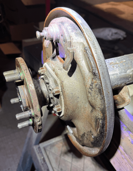

The driver side doesn't have this set up. this is driver side

Dr Diff and Yukon gear. There is an inner and outer seal on our cars. One inside the housing tube and one in the bearing retainer. To do the outer one means the bearings have to come off. The bearing is pressed onto the axle and there is a retaining collar there too. Collar has to come off first, then the bearing. Both get destroyed, so it's a good time to replace. Bearings get packed with grease, use the same stuff as the front wheel bearings. Use only Timken bearings for your replacement, no Chinesium junk or you'll be doing it again soon. There is a procedure for setting the end play on the bearings. The rh side in your picture shows the adjuster. Here is some info on what you'll be doing.
Chrysler 8 3/4 Axle bearing and Seal R&R...A How To
