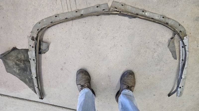

My oldest friend is restoring a Road Runner for his daughter and is having trouble finding the seal "flap" for the glass? He has a metal strip with attached rubber seal (decomposing). Can anyone school me on this design? Thanks!

I relooked at the setup and now understand more about the design. Where can the rubber seal by obtained? And are the twist clips reproduced?

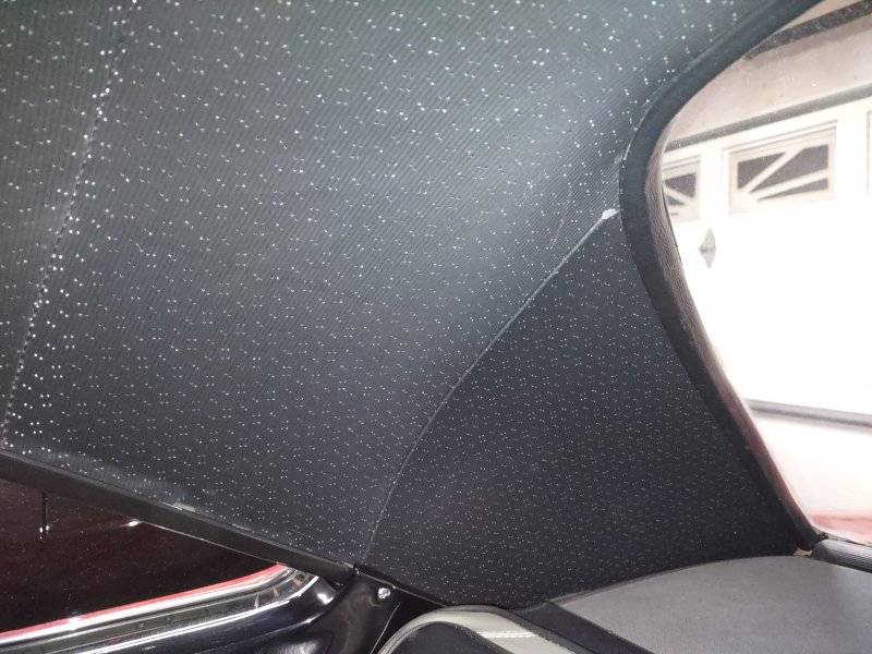

Im restoring a 70 RR and doing the headliner - question on the finishing trim or "Reinforced rubber " that dresses up around the rear window. I disassembled my car 20 years ago...took lots of pics - but never enough....how does the rear window rubber finishing trim get fastened on the inside at headliner??
Just did this on my 70, trim slips over teeth that headliner is stretched over. I used a heat gun to slightly warm up trim in a couple of areas to get it to form better in the corners. Tapped it on lightly with dead blow hammer. Bottom trim is stapled on hard board speaker cover.
