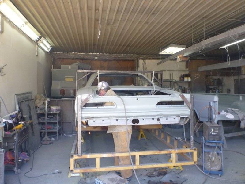

I wasn't there when my metal guy Drue did it, but he put the one piece in my Bee without pulling the tail panel...

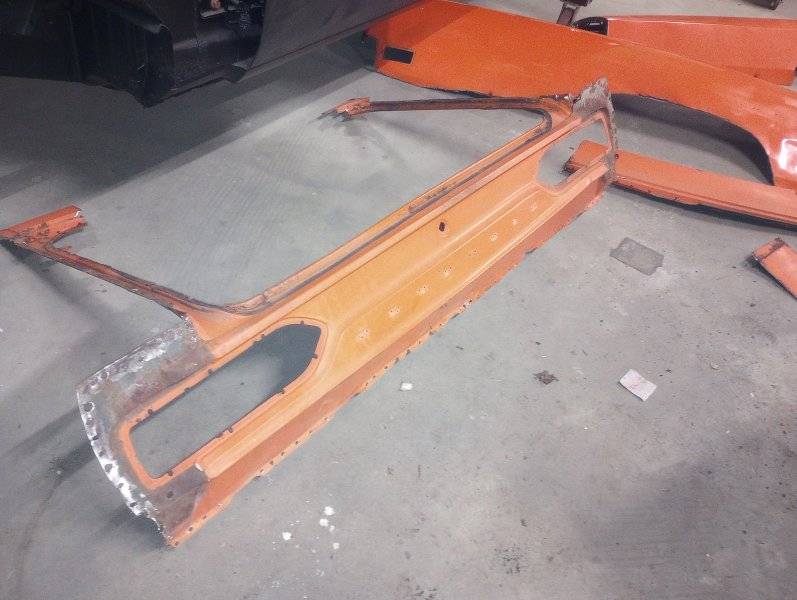

I put a full pan in a 67 Belvedere by removing the taillight extensions and then cutting a 2” horizontal strip from the taillight opening to the trunk opening on both sides. After i slid the pan in and welded it, I welded the horizontal strips back in. Bodywork was minimal and the only paint work was in the trunk gutter area. If you have a 68 or 69 Plymouth this technique will work for you.
