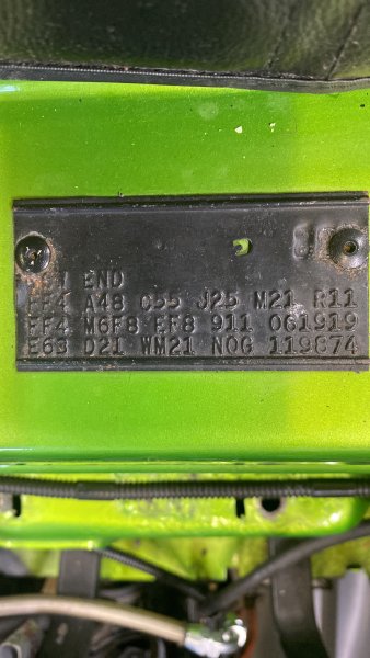

Is the fender tag present?
If that's a factory four speed with AC car, it's not too common.

Low option tag, and don't se H51 for AC. I do see D21 for the four speed.
F4 is a more traditional green, and an F8 dark green interior.
Why is the tag riveted instead of screwed?
Not trying to bust the OP's chops, just pointing things out.

Not sure why it’s riveted. This is how it was when I got it.

Low option tag? I added the vintage air condition.

Given that most options were not coded on a tag or only sometimes coded on a tag, it's very difficult to draw a conclusion or make any correlations between how the car was actually equipped and what is coded on a tag.
