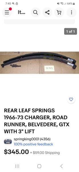

1970 GTX lift rear about 2" without changing leafsprings, any options would be appreciated.
I just got a quote locally to have my springs re-arched. $280 , be ready in week to 10 days
talked to Detroit spring , and new ones delivered were well over $400 with 60 days lead time

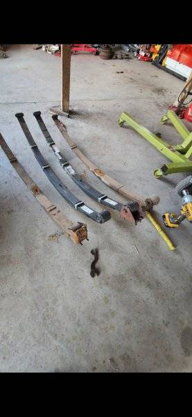

Have you guys talked to Laura at ESPO? They are more competitive than Detroit. I would recommend new ESPO way before spending $280 to re arch old springs. I tried that once, and they were back to sagging a year later.....
Instead of wasting your money on a hope and a prayer, save your pennies and do it right.
New springs. If you can afford gas you can not afford not to do it right.
2" is too much for a coil over standard shock to do and as said before every time you would hit a large bump it could be the last for that shock.
But at least new replacement rear upper shock crossmembers are available from AMD and others. Start about $300 for the part alone.

The cheapest, safe way is to install helper leafs. $50 and up. Check with your local chain auto parts store
