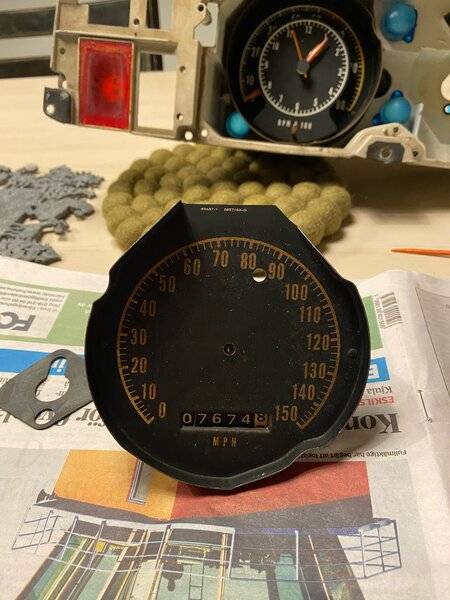

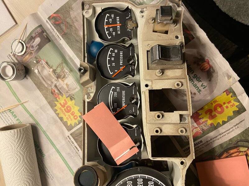

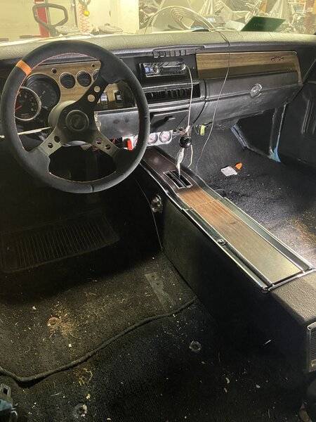

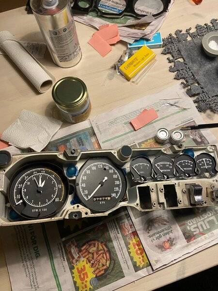

Some job with the instrument cluster.
Just sticker but it will do.
Some one painted the neadles orange.
Now it is white again.
D32CF87C-E6AB-4392-90B7-1A7875B2270B.jpeg 93CB28F5-CECC-486B-9C58-BFE4AEF7ADD3.jpeg 61A335F6-1F36-4D78-91DB-CC4B154A2C83.jpeg

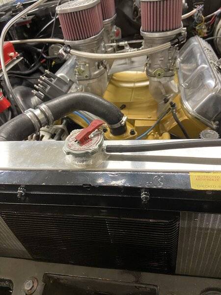

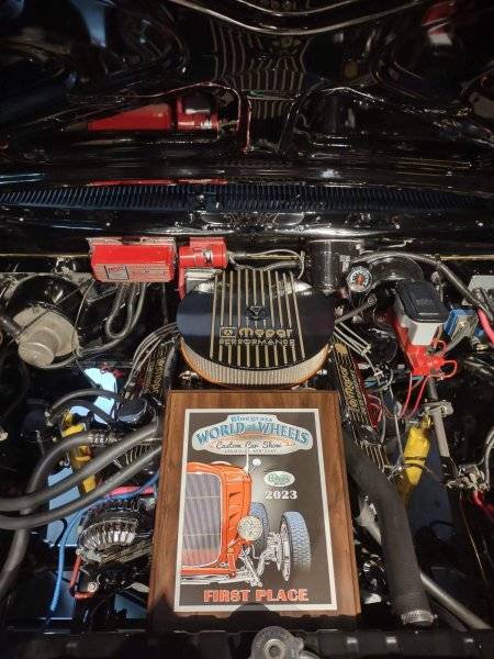

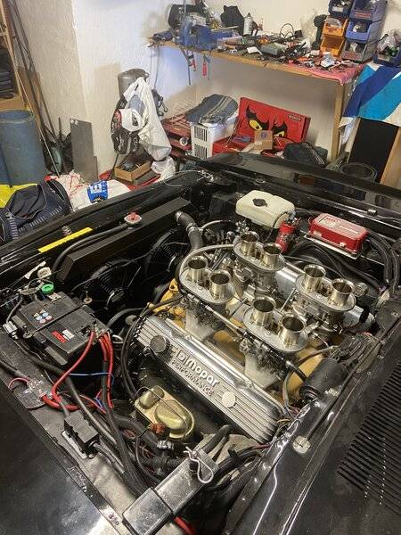

Heat regulator to the spal electrical fans and a b&m transmission 32 row oil cooler.
438E8135-7872-4B4B-80C8-339BEF5FF332.jpeg CF2B4D00-7194-4449-A824-5AC941D8FCBD.jpeg

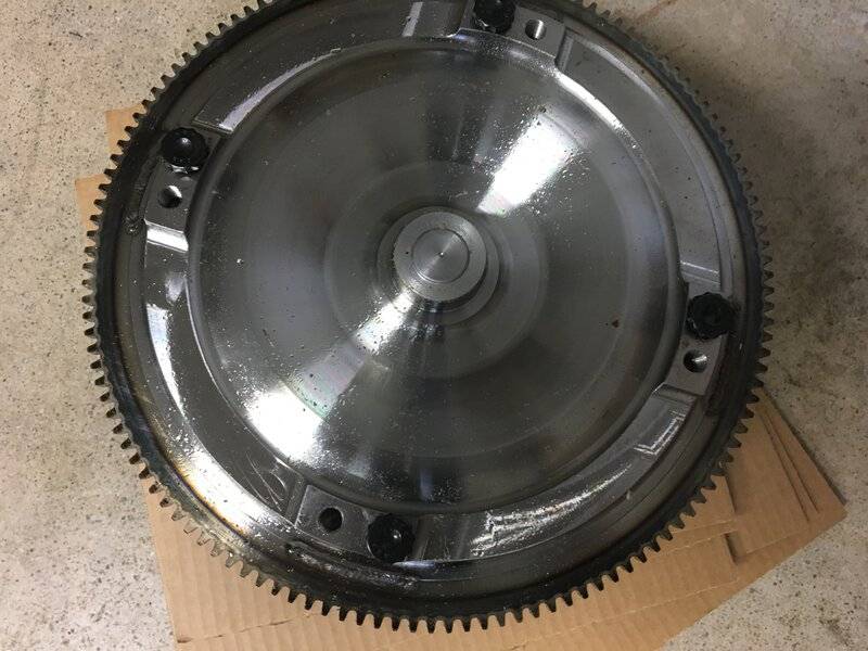

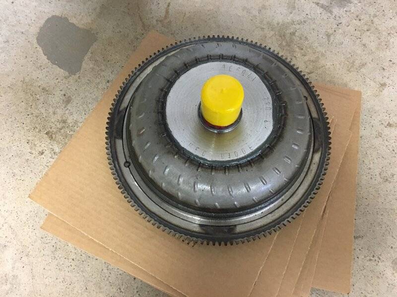

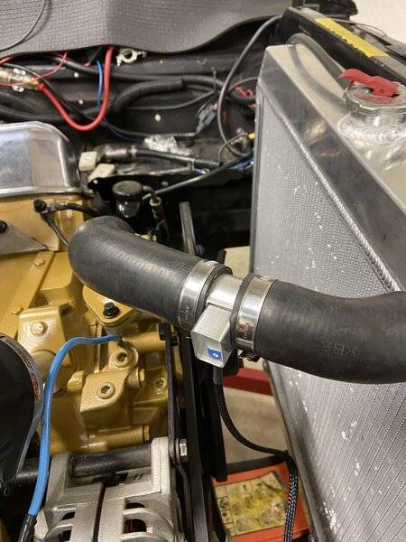

3500 stall 9.5” custom built (in sweden)converter. It stalled 3500 with the 440 probobly higher now.
3843ED43-458B-4FB7-92F6-4D8391386200.jpeg E4A14C58-FA23-4CCA-99FA-4C12BAB8E969.jpeg
After burning out 3 motors of an allegedly "trouble free" brand of 2 speed, 18" fan motor, with all the required (or better) relays, amps, circuits, alternator output, no significant voltage drops...
I installed an 18" mechanical flex fan and 2 SPAL appx 11" fans, using the same circuits. One fan for "low" speed, then the other comes on for "high" speed. I noticed 90% of the classic cars at a local show w/electric fans used SPAL. I haven't had a second of trouble with SPAL.

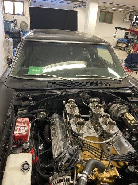

Now it`s up and running, first testdrive yesterday.
Just a couple of miles just to se if it has any problems.

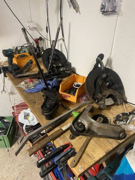

Suspension upgrade Hotchkis 1 1/8”
A lot of header bashing to make it fit. But only the driver side.
Polyuretan bushings front and back.
