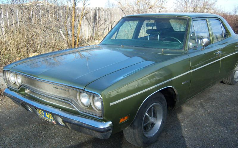

1970 Plymouth Satellite model RH41
Looks great! I bet that car will be alot of fun
hope so... so far just a lot of work.

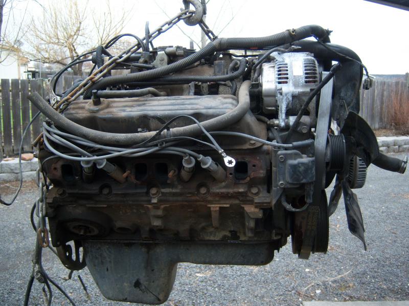

I'm going to go pickup a '97 magnum 360 engine to freshen up and replace the 318.
port fuel injected 360 engine for the Satellite
You never know what to expect when getting parts from an unknown, this time it worked out good.
I got the 1997 360 cu in. port injected engine with the wiring and engine control unit, sensors all but the O2's

I was able to help take the engine out which was a good deal too.
what a nice upgrade, roller cam, swirl port heads and a few more cubic inches.

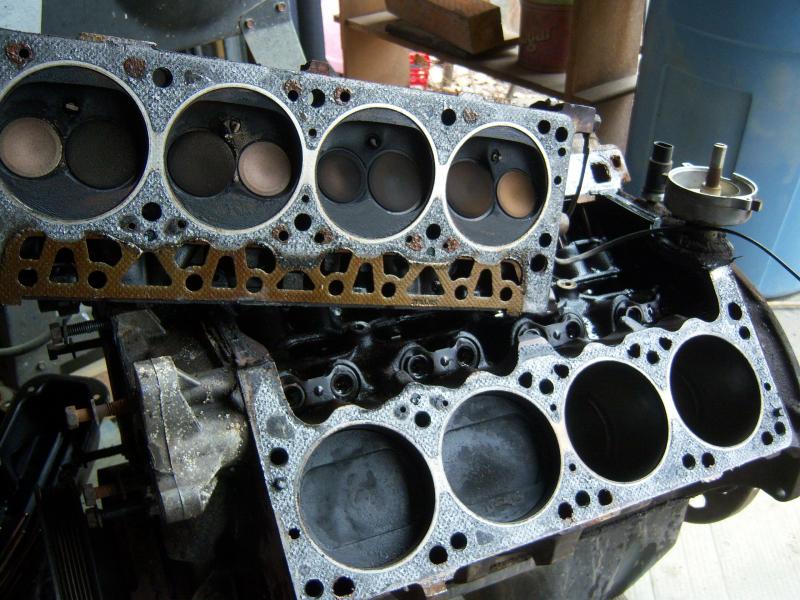

Dyno testing any engine before installing {if at all possible} is the best way to go and time well spent.
I am amazed at the condition of the bore and pistons.

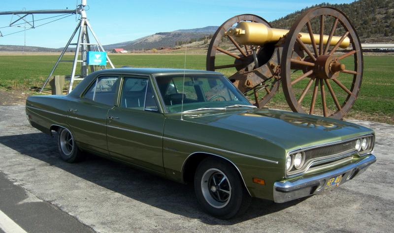

If a person doesn't get carried away "over restoring" it doesn't have to take years and 10's of thousands of dollars to build a nice Mopar. To finish the car I need to water test and seal the glass and install the revel moldings and cut and buff the clear coat. The 318 runs strong which is good since the fuel injected 360 will have to wait, I have a 73 Charger to get to work on next.
Great car and build! Like you say: It shows what can be done on a budget.
I think the car came out great, and I'd be happy to drive around in a car like that!

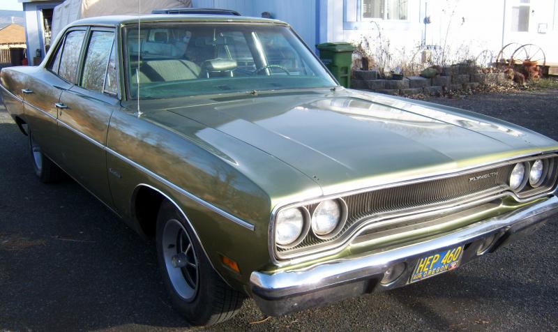

Test drive for the Satellite
Thanks Hawk and Dave.
