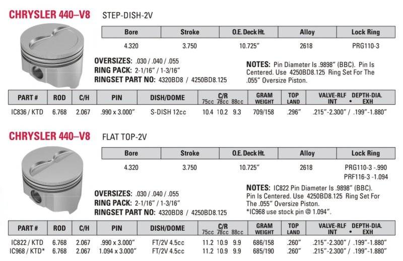

Yes, Kb, Icon and Silvolite are all made/offered by UAM.
But not Icon from the shelf on stock stroke for 440… not at least on their website.
Silvolite offers them thought… 1.912 and 1.969 CR for flat tops and 2.023 for dished
Below are the icons from their list. There is one stepped piston available.. but has a dish. I have not yet seen a forged stepped piston flat top like the kb pistons. But we have a stepped icon flat top in our 542.
The op needs to be aware that any piston with a bb chevy .990 wrist pin will need aftermarket rods or the stock rods will need to be bushed. Also pistons can have different size rings. Thinner rings typically free up a couple hp. Also plan to balance the crank with lighter pistons.

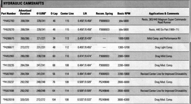

The cam specs…
Is the basic Purpleshaft camshaft PN P4452783
Although those specs are aprox and the real values measured by experts are here:
Chrysler High Performance Cam Data

The cam specs…

Nacho, do you have the cam specs for a stock '73 440 HP for comparison?
Is that one… the MP P4452783 camshaft was a factory production camshaft for all magnum engines. It got several supersedes numbers along the years but that was the last PN asigned and included on the MP catalog being the factory replacement.
The real specs are posted onto the victory library link I posted on same reply
