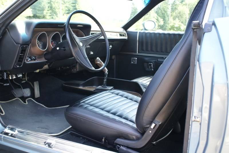

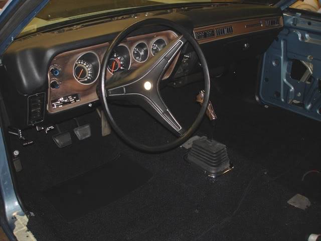

Another clue that the car never had buckets originally is the lack of reinforcement plates welded to the floor around the inner seat track holes.
Yeah, that's a good point. I'd put those plates in there. The dreaded previous owner of my vehicle didn't do that when he put buckets in the place of the bench and he put a nice big tear in the floor pan that I had the joy of fixing. You could always use really big washers instead of the brackets, but the brackets are cheap and easy to weld.
