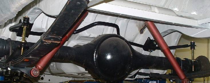

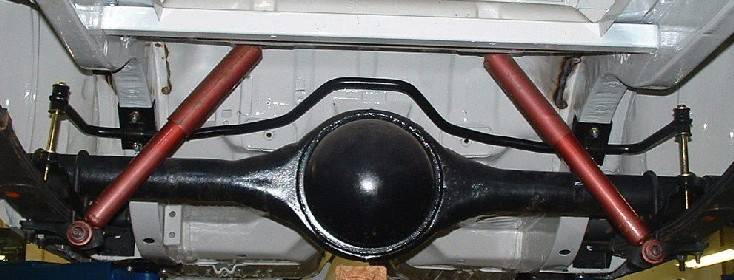

I bought one from Firm Feel for my 71 Super Bee.
Not installed yet, appears to be nicely designed.
It mounts above the rear differential, keeping it for the most part unseen from the rear of the car.

It's interesting that the firm feel looks like an ebody, in terms of mounting.

Isn't there a sway bar that is located under the rear end housing?
That upper located sway bar may be fighting for space with the tail pipes...no?
72 and up B-body are that way. This is my 74.

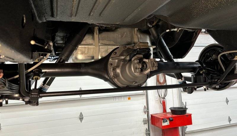

Manzolds, your Super Bee underside is almost the same as the underside of my Roadrunner.
Here's a photo of when the exhaust was being installed on mine (about a month ago).
Look closely to the right of the muffler - the previous owner(s) welded a plate to the frame rail, which I assume would be for a rear sway bar.
This will give some idea on how much real estate is there when everything is in place.
BTW that is a 2 1/2" tail pipe.
Also, I do have the same 72 & up rear sway bar that T2R9 is showing in his reply - I still need to clean it up and paint it and buy new bushings for it.
Hello 71 Beeper,
Thanks for the picture.
Judging by the picture, it looks like there will be sufficient space for the exhaust to clear.
Will know soon enough if this is going to work.
Hopefully Firm Feel accounted for the needed space for the exhaust, fuel vapor lines and brake lines., I already have drilled the crossholes for the brackets through the frame rail.
