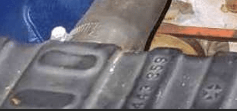

Many of the 440 HP Chargers I have seen in 1971 have the radiator upper hose outlet on the passenger side of the radiator. A few have it on the left (driver's) side. Anyone know why they used 2 different ones? My right side upper outlet is a 959 radiator. Is the 960 radiator used for the left side? Just wondering. Thanks.

My car has a 959 radiator and it is on the passenger side.
