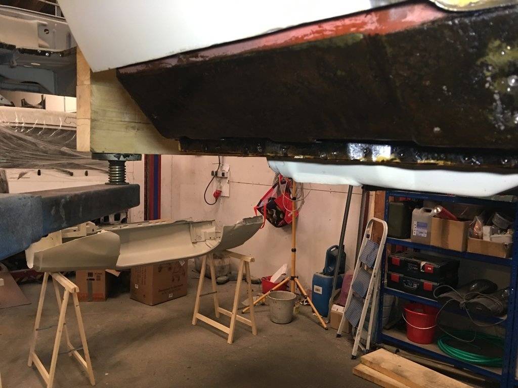

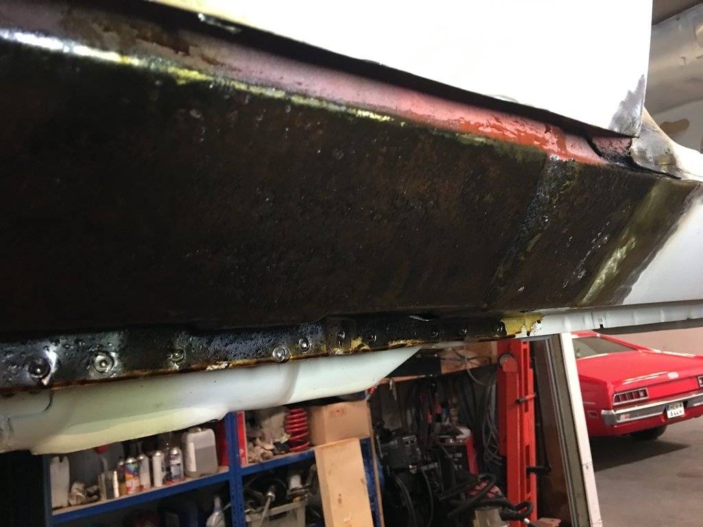

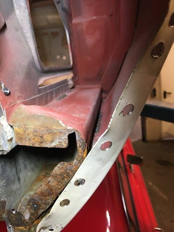

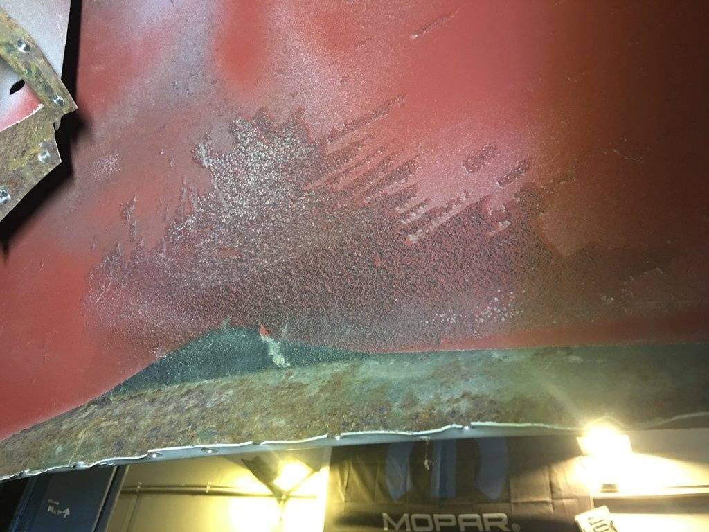

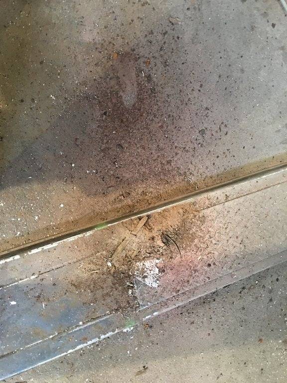

The RH side ist a bit "crusty" underneath the front quarter panel :( ...
Hi,

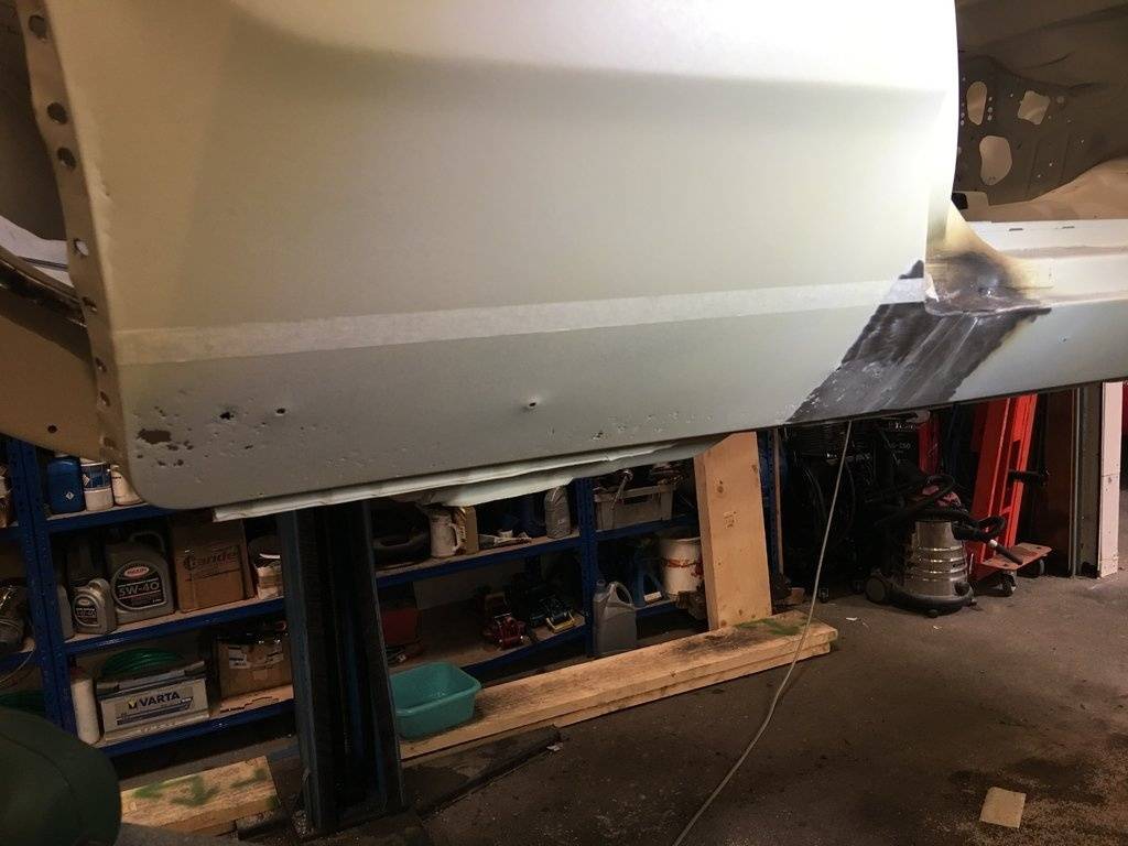

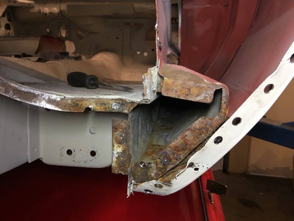

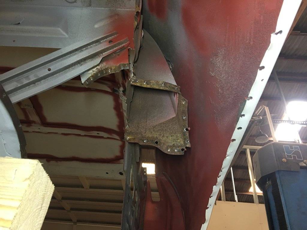

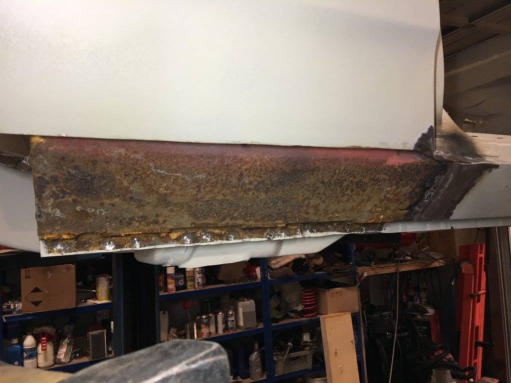

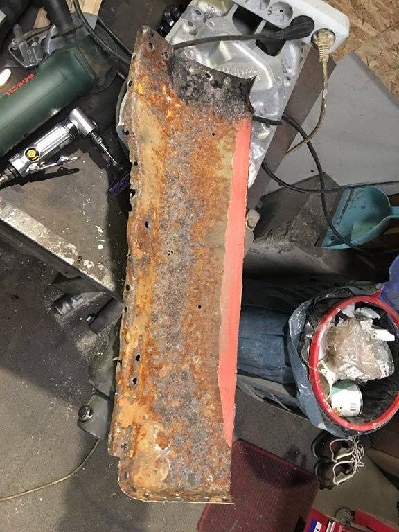

Some more progress, I started with the rusty lower quarter panel RH.
I have to say ... if the engineer who engineered this section still lives, I like to punch him in the stomach !

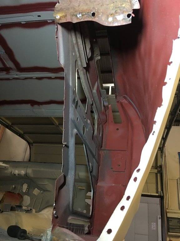

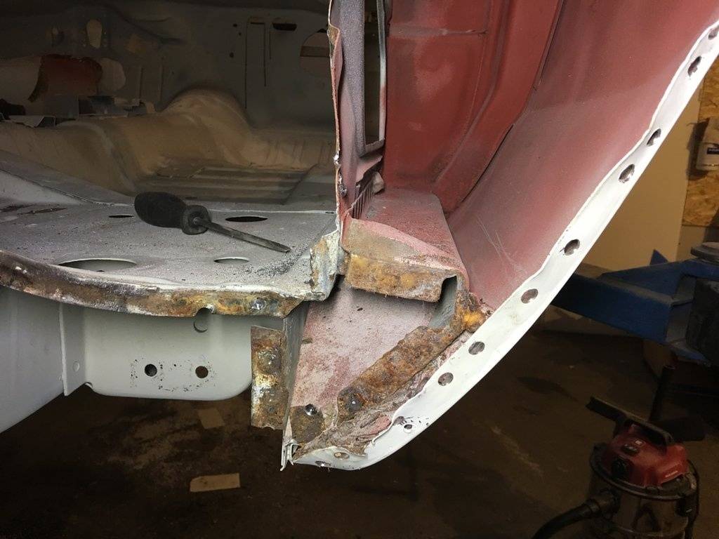

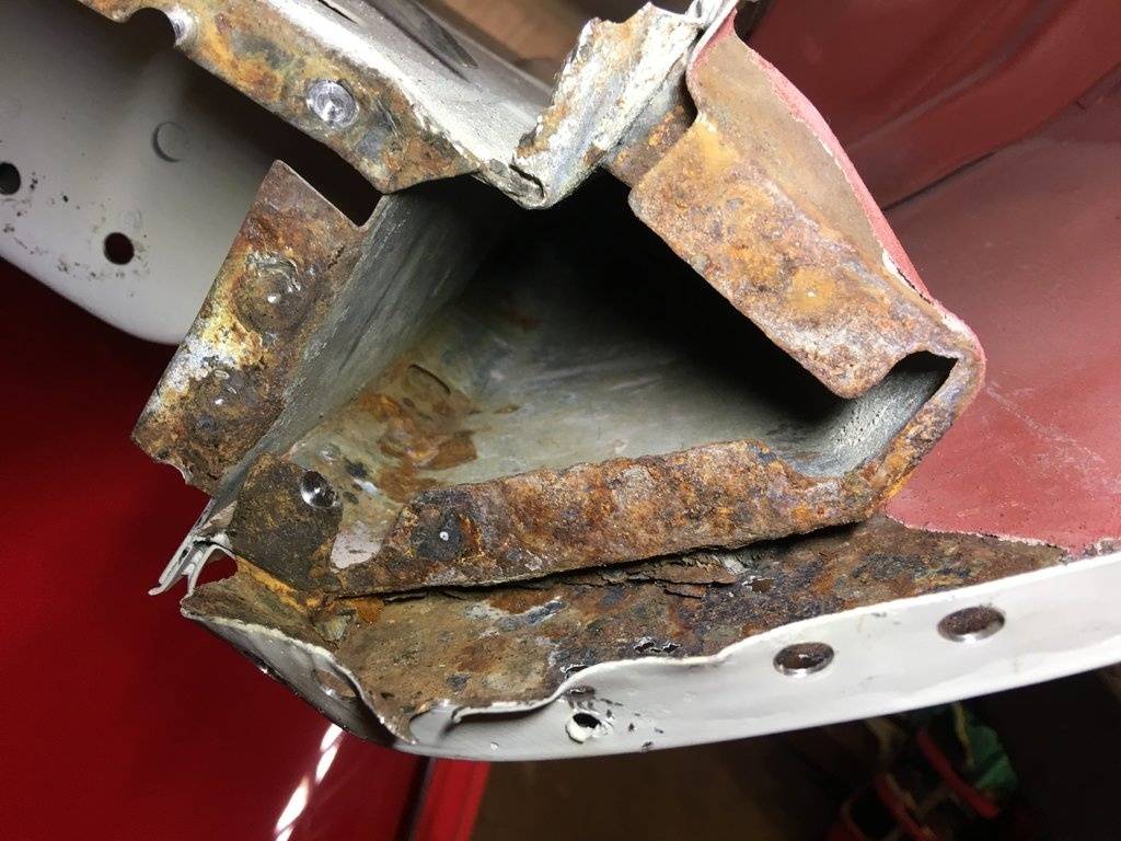

First I removed the cavity sealant where the quarter panel and the rocker panel come together.

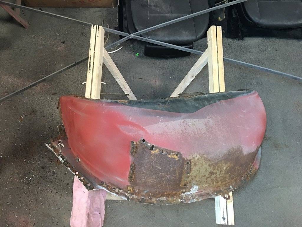

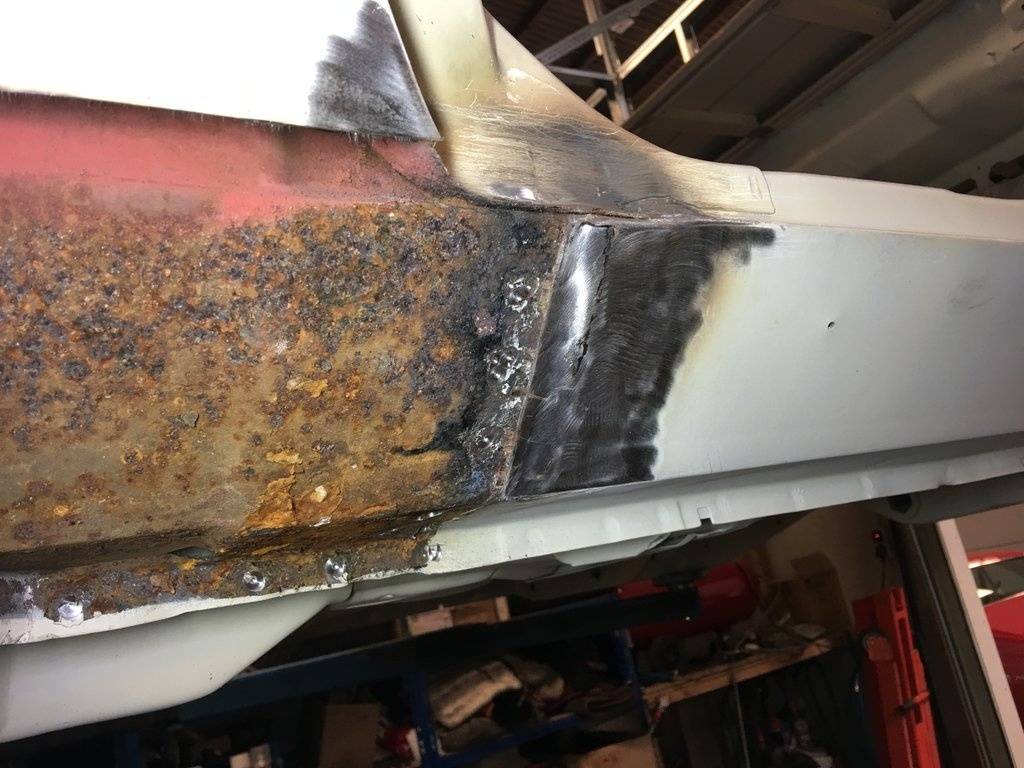

After that: again spot weld drilling ...

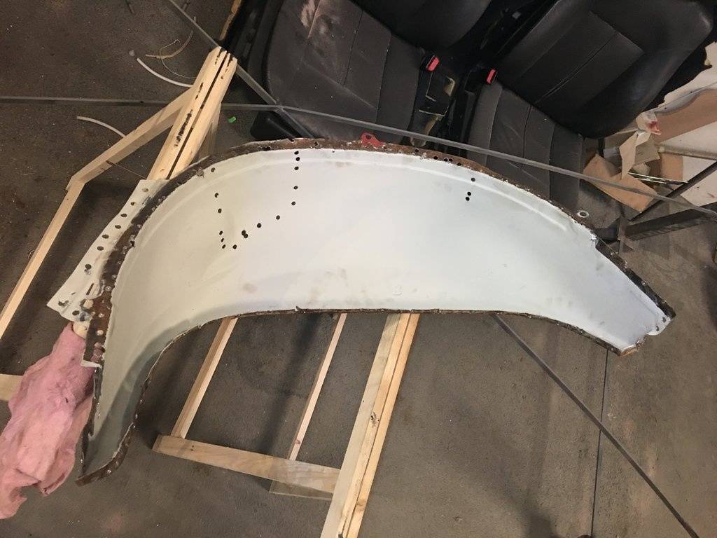

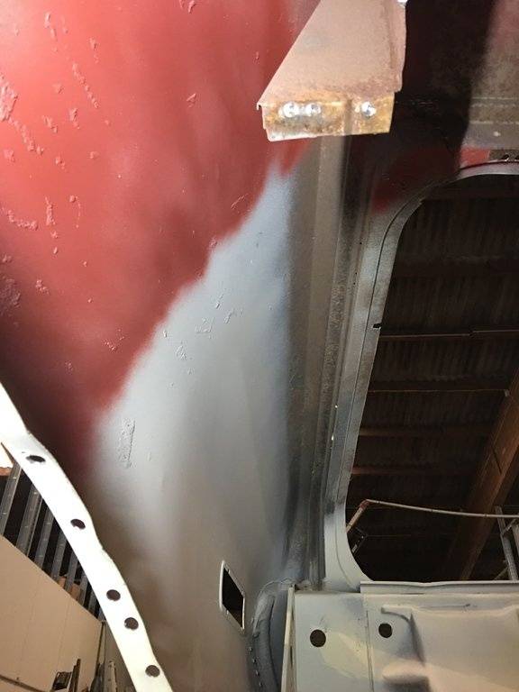

I removed as much of the rusty surface as possible and used again Fertan (rust converter).

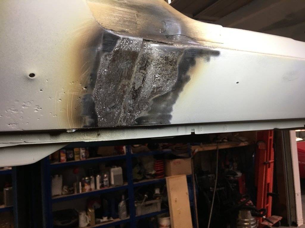

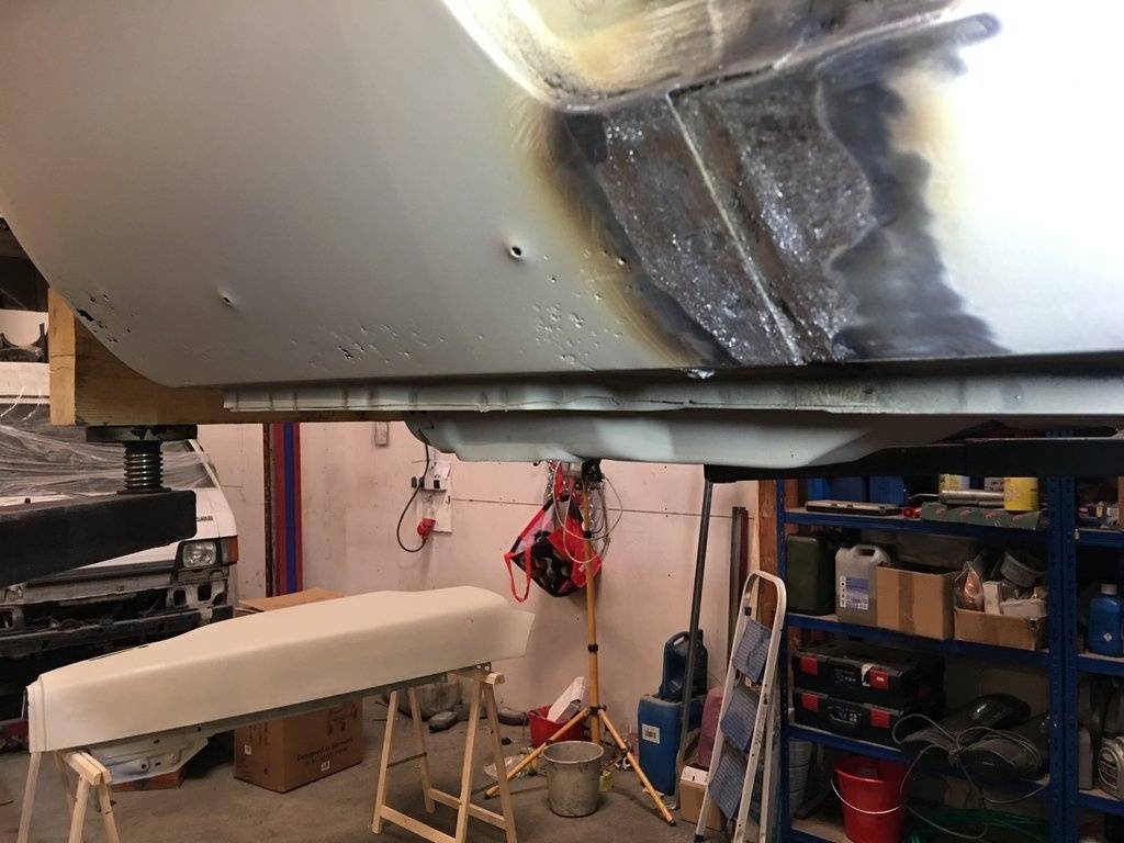

Before I will close it again, it will be painted (rust prevention and paint) and I will use welding primer.
After I welded in the lower quarter panel section, I will also use Mike Sanders to prevent future rust.
