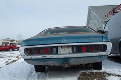

I thought hideaways could be optioned on a Rallye, not positive though.
They do have the R/T tail lights.
They share the outer wheel tub with 72 Charger. Not 73/4 and not Satellite.
Thank you some more good info to know. I was told the tail lights where used on R/Ts and the Rally in 72.
So if I buy full wheel housing will it need mods done to it?
