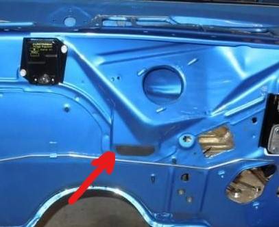

That's very good to know. Can you send a close up pic of the slot? How did you make the slot in the sheet metal?
I cant get a shot right now the car is away for the winter. The slot is where the two firewall sections meet at the low point. What you can do is cut a slot about 1 inch above the welds. Then pry it away from the inner firewall to leave a slot. You need to put seam sealer where the upper and lower firewalls meet. This will keep water from getting to the welds. Also there is a small rubber flap that goes over the slot
